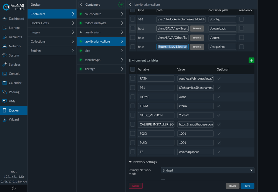

Hello, I tried adding the docker container on Freenas. but the webUI doesnt seem to work. Screenshot below Am I missing some setting?
Update here, so this worked for me but the books in my Calibre db are not appearing on Lazylibrarian. I have done as suggested in the first post above. Anything that I am missing here?
You will need to "Library Scan" for it to scan the book folder / calibre db
got it! thanks for the help!
