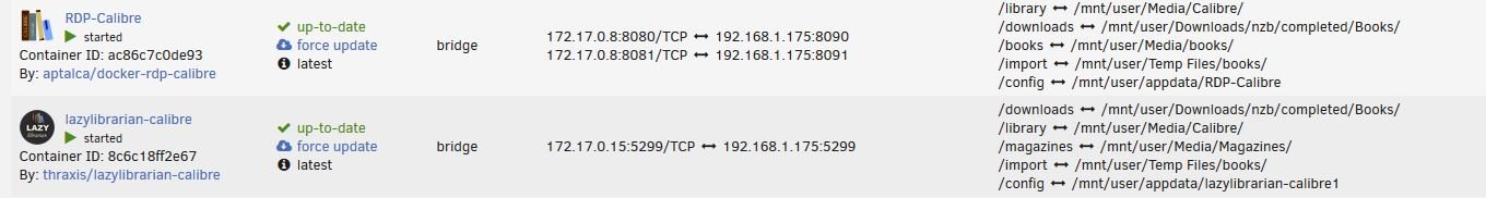

Can someone help me out configuring this with Calibre?   Much like a few others in this post im lost about how this actually works.  Ive been setting up Sonarr/Radarr/CP/Sickbeard/Sabnzbd stuff for years but this shit just makes zero sense and the documentation for what directory goes where is pretty crap.
I want the books from LL to download, be imported into Calibre and have some way to convert/push the books to a kindle for my wife easily.  All automated, ideally she add's a book to LL, it will notify her when its done, she will go to Calibre, and push it to her kindle.  Seems pretty simple but I for the life of me cant figure it out.
I have two folders  both visible from my LL+Calibre docker
/books/Calibre
/books/LazyLibrarian
In LL i have my download Dir set t o /books/LazyLibrarian, this is where Sabnzbd drops books
I also have my ebook Library folder set to /books/Calibre
When a book is downloaded, after i force LL to post-process i end up with a folder in my /books/Calibre folder with the authors name, with the book subfolder, cover, metadata etc as expected.
But when i launch something like Calibre-Web  and point it at my calibre folder, or the calibre windows app nothing shows up.  If i check the library in the windows app it says that there are extra folders in my library not in the database showing my books in /books/Calibre/<AuthorName>/<BookName>
If i manually go into the my dockers terminal instance and run something like /opt/calibre/calibredb add /books/Calibre/* --library_path  books/Calibre/ -r it imports the books into my database and the client shows them.
Why do i need this manual step?  Whats the point of giving my calibredb path inside LL if it doesnt seem to be actually doing anything with it to get books into the database?
I feel like im missing something fundamental here and this shouldnt be so complicated.
Thanks in advance.

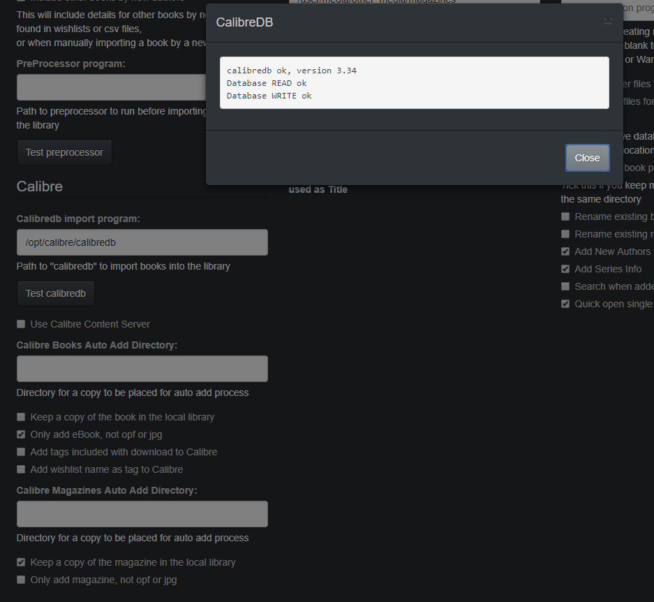

Can somebody help please.
I am unable to import books via LL calibredb using the content server.
I have LL docker and the rdp-calibre docker installed.
I have enabled the content server with a username and password.
I have read / write access to the db
calibredb ok, version 3.42 Database READ ok Database WRITE ok
I have the same paths mapped for the books library and download paths and a import path.
When I try to import for example I get this error
11-May-2019 12:53:42 - DEBUG :: IMPORTALT : librarysync.py:find_book_in_db:171 : Searching database for [The Girl In The Clockwork Collar] by [Kady Cross]
11-May-2019 12:53:42 - DEBUG :: IMPORTALT : librarysync.py:find_book_in_db:215 : Exact match [The Girl In The Clockwork Collar]
11-May-2019 12:53:42 - DEBUG :: IMPORTALT : postprocess.py:processDestination:1889 : Importing Steampunk Chronicles - The Girl in the Clockwork Collar - Book #2 - - Kady Cross into calibre library
11-May-2019 12:53:42 - DEBUG :: IMPORTALT : common.py:runScript:1313 : [u'/opt/calibre/calibredb', 'add', '--username', u'calibre', '--password', u'calibre', '-1', '--with-library', u'http://172.17.0.8:8081/', u'/import']
11-May-2019 12:53:43 - DEBUG :: IMPORTALT : calibre.py:calibredb:434 : calibredb rc 1
11-May-2019 12:53:43 - DEBUG :: IMPORTALT : calibre.py:calibredb:438 : calibredb res 218[Traceback (most recent call last): File "site-packages/calibre/srv/cdb.py", line 48, in cdb_run File "site-packages/calibre/db/cli/cmd_add.py", line 64, in implementation KeyError: u'format_group' u'format_group' ]
11-May-2019 12:53:43 - DEBUG :: IMPORTALT : calibre.py:calibredb:439 : calibredb err 0[]
11-May-2019 12:53:43 - ERROR :: IMPORTALT : postprocess.py:process_book:1741 : Postprocessing for u'Steampunk Chronicles - The Girl in the Clockwork Collar - Book #2 - - Kady Cross' has failed: u'calibredb rc 1 from /opt/calibre/calibredb'
If I use the rdp-calibre gui I can import the same book with out issues from the same dir.
Not sure what I am missing?

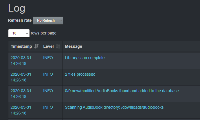

Hi. It's been awhile for me on the unraid forums. I use to manually find a book, download it and then update Calibre. I use to have a calibre server I ran from my windows machine but it has been years so no problem with starting fresh.
I want to automate this and it seems I need to run the following; lazylibrarian-calibre, Calibre server, and calibreweb or cops.  Is that correct? Is there a certain order I should run/install the dockers?
Thanks!
