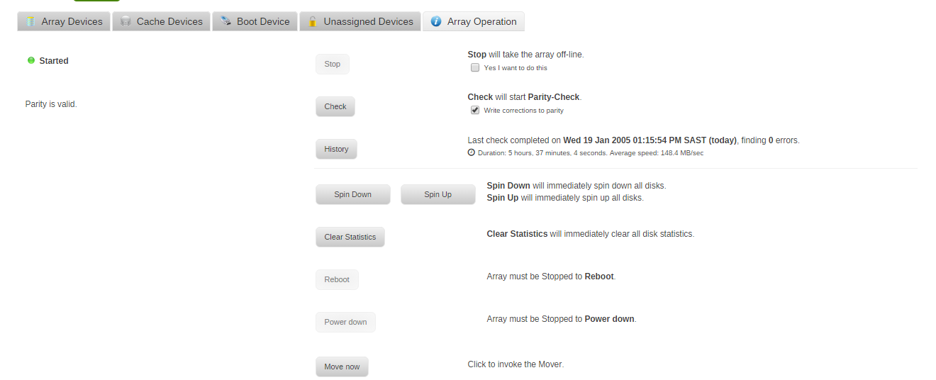

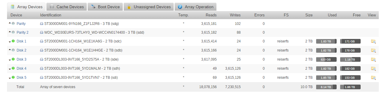

Attached are the results of the procedure which I assume has now corrected the disk issues.Zero parity errors reported.
Thank you
Everything looks fine now and it should all be OK, but run reiserfsck --check on both rebuilt disks to make sure there are no file system issues (you can use the GUI or the console).
