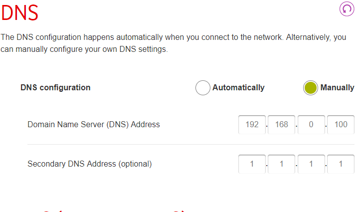

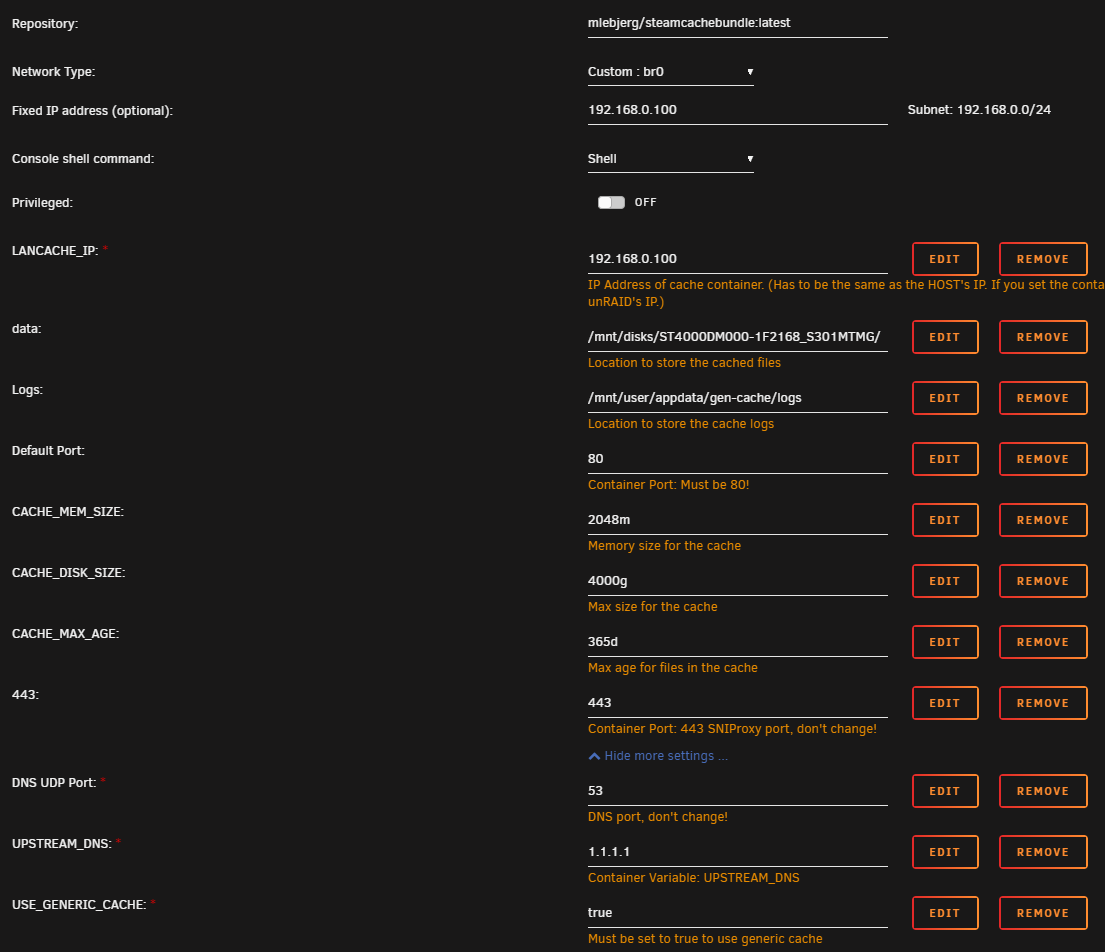

Hi All,
I am having some trouble with the SteamCacheBundle container. I have it setup and it is working but not giving me internet (UPSTREAM_DNS) unless i put the alternate DNS in myself(IPV4 settings in Windows) it is not picking it up from the container. On my Windows PC this appears to be OK as i can see me getting items to cache when downloading but on my router it bypasses the Cache and goes to the alternate(Secondary).
What am i doing wrong ?
Here is my container setup
And here is my current Router setup (It is a Vodafone Router in the UK)
If i remove the Secondary i loose internet and all web pages display "DNS_PROBE_FINISHED_BAD_CONFIG"
And i did do a ipconfig /release followed by /flushdns and /renew
TIA

8 hours ago, JPDom1 said:
Hi All,
TIA
whats your unraid server ip ?
192.168.0.4 i made it different for this container. I also use my network with LAG 802.3AD not sure if that can cause a problem?
nah just checking wernt same ip as cahce server
