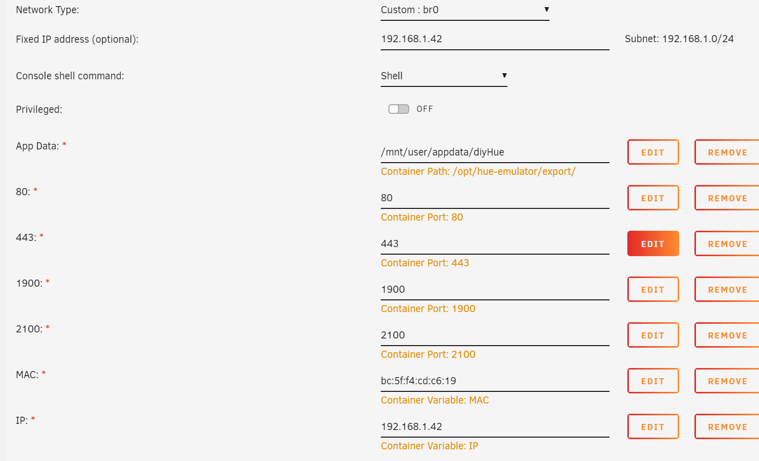

On 11/22/2019 at 2:13 PM, mgranger said:
I am now taken to the IP address I put in but nothing comes up.  I get an error that the site can't be reached.
I have just installed this container on my machine and it worked perfectly first time. Take a look at my settings in the screenshot below and make sure they match yours. The fixed IP for br0 can be anything, so long as its in the same subnet as your unRAID machine and is not already in use. The MAC value should be the same as the MAC address for br0. The IP value should be the same as the value you set for br0. That should then work perfectly. Then you just need to browse to the IP you set for br0. In my case this is 192.168.1.42
