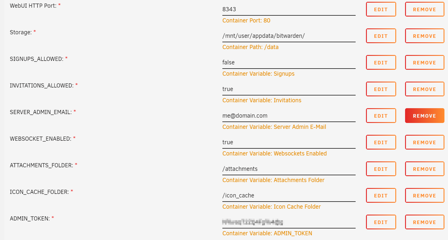

I havnt written a guide, nor do I know if one exists specifically for unRAID. However here is my config:
Admin email can be anything, it's only used if you set the SMTP parts up for sending admin emails. I don't use that function as I'm the only one using bitwarden. The admin token is the password to the admin interface accessible at /admin. This is different to the normal bitwarden webui. You can set it to what you like or disable it, instructions in link in first post, but I don't recommend that.
As for remote access, I have my instance behind a reverse proxy provided by the linux server let's encrypyt docker image. Here is my config for that.

Thanks for all the help, I'll definitely have to reference the reverse proxy config.  My issue is that I can't seem to set anything up.  I go to the web UI and can't create an account (when I try, it just sits there - do I need to enable Signups temporarily?).  I'm pretty much starting from scratch so I'm just not sure how to get my account going.
Edit: So I think I started to figure it out: I enabled the SMTP server stuff (w/ a gmail account) and invited myself to create an account.  When I created an account this way, I was able to do it.
Now I'm trying to figure out how to get the Duo stuff to work and creating logins in general.
