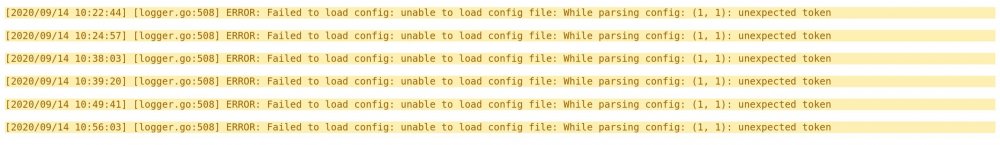

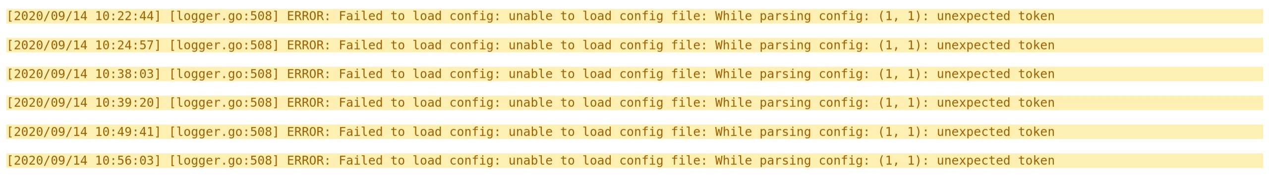

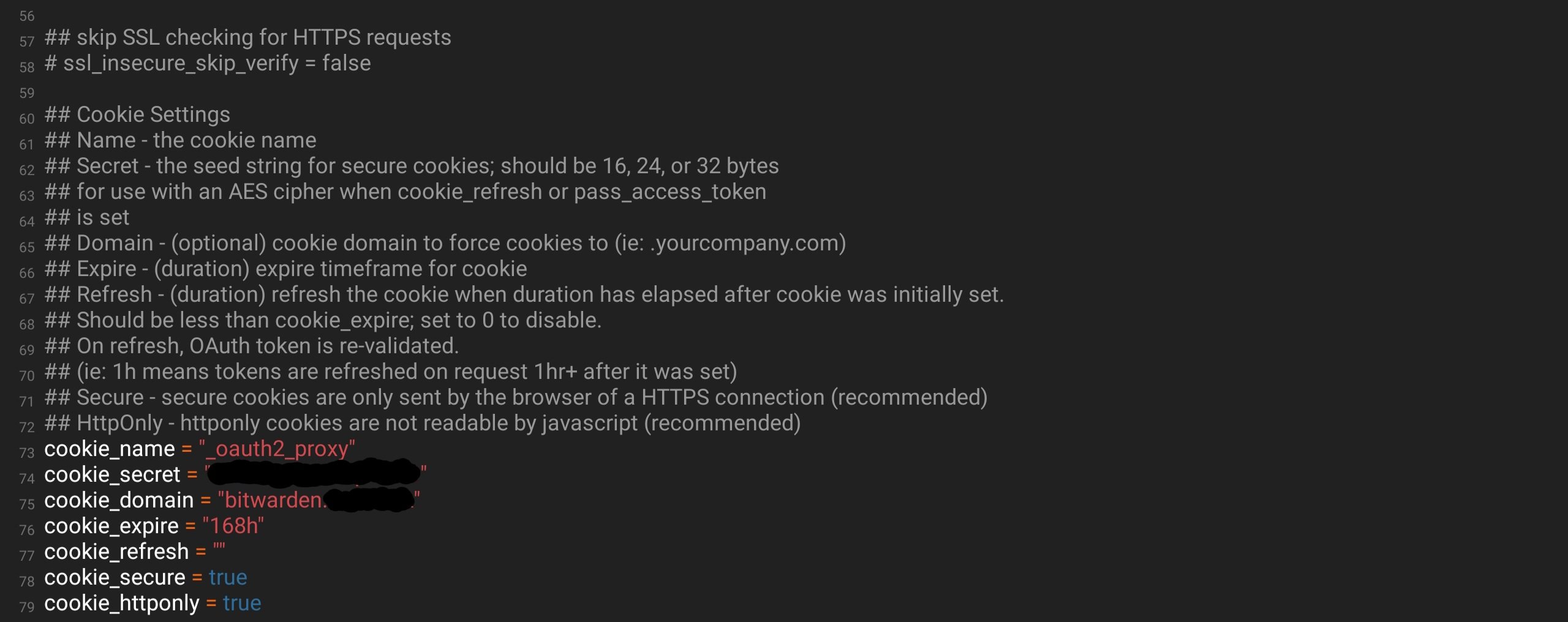

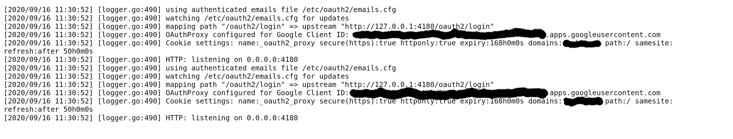

I was hoping someone could give me a nudge in the right direction.
I'm trying to setup OAuth2 and have followed the guide here; OAuth2 Guide
My problem however is that I am receiving a "Failed to load config: unable to load config file: While parsing config: (1, 1): unexpected token" error. I've gone over the config file several times and I can't see where I have formatted it incorrectly.
For reference, I am trying to set this up for my remote access to bitwarden. Once I get it working I hope to expand it to my other containers.

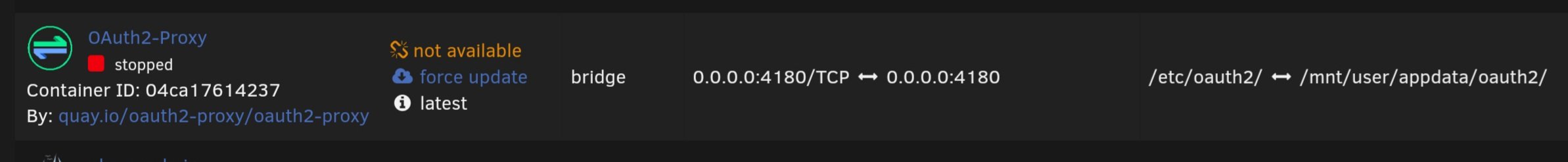

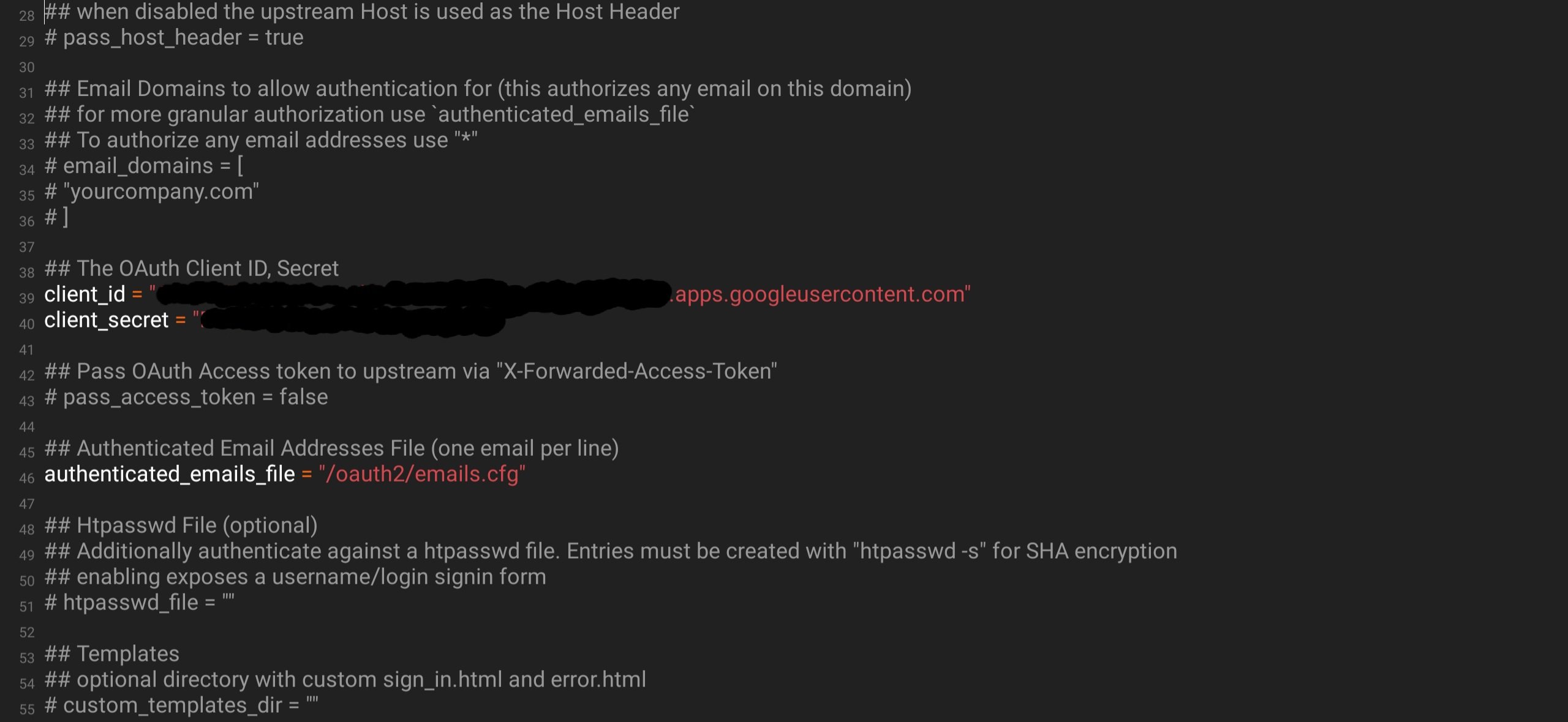

I have included some screenshots below in the hopes that someone can point out my mistake.
Many thanks.
Edited by LoneTraveler
Many thanks.
Everything there looks ok. Have you put an email in the emails.cfg file to authenticate against?
Many thanks for replying.
I have just the one email address in the emails.cfg file, and it's the same one that I use to login to my Google account to obtain the client ID.
***Edit - Just to add a little further, I've completed up to step 12 of "OAuth2 Proxy Setup", however it is here that I am getting stuck as the container will not start, preventing me from moving on to the next step of "configuring NGINX".

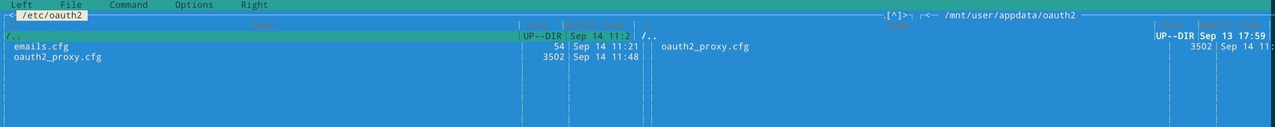

Can you confirm what files you have in /mnt/user/appdata/oauth2/
You should have emails.cfg and oauth2_proxy.cfg
I couldn't tell from your screenshot.
Yes, those are the only two files I have in that folder; emails.cfg and oauth2_proxy.cfg
Regards.

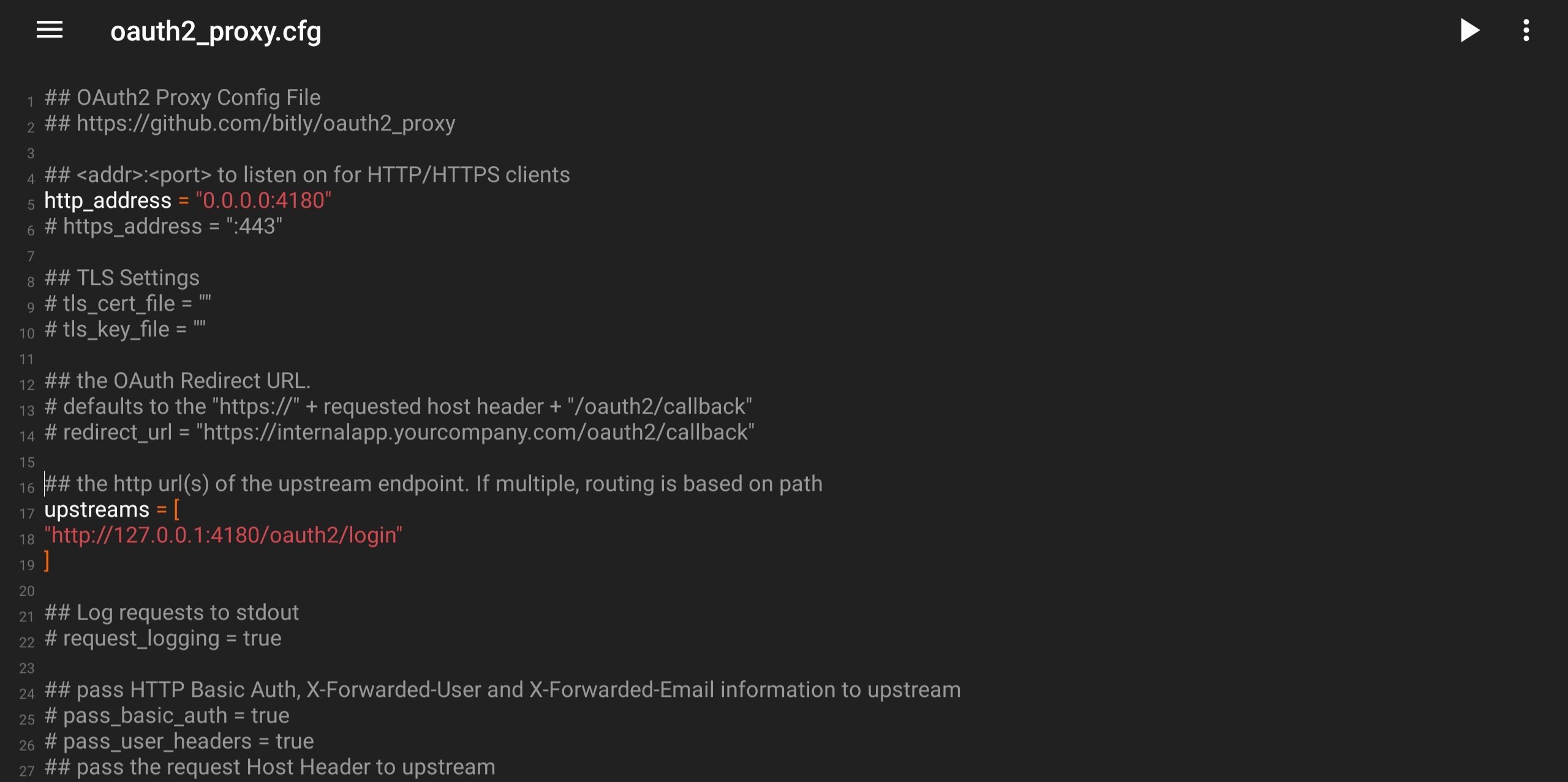

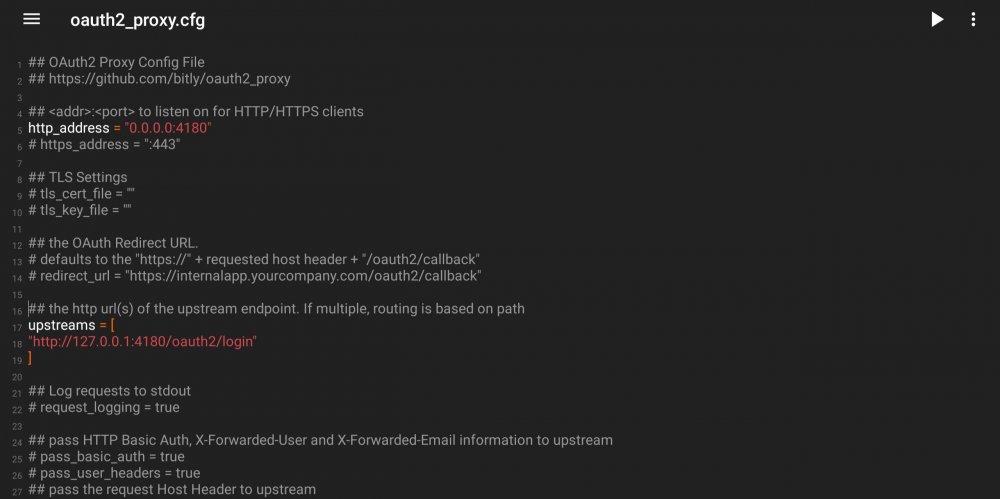

Regards.
Then the only thing I can think is that perhaps your line endings have gone wrong. I have attached my config, minus my secrets. I marked the values that you need to replace with REPLACE_ME then replace your existing config with my one, as I know mine works.
Make sure you use an editor that adheres to linux file line endings such as notepad++
oauth2_proxy.cfg
You're a gent, thank you very much!
Worked like a charm, thank you very much!
