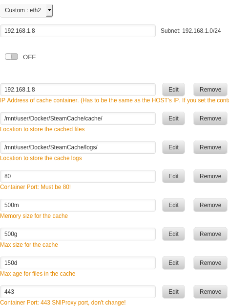

I've been trying to setup Steamcache (and now SteamCacheBundle) on unRAID for a long, long time, but I've never gotten it to work.
The issue I keep seeing is that the container itself doesn't seem to have internet connectivity, no matter what upstream DNS server I use.
I've tried both a dedicated NIC and IP for the container, as well as bridged. Everything should be working, but it's not.
It almost seems like it's able to resolve Steam-related DNS requests, and everything else is just dropped.
Anyone else seeing the same? Any advice on what to try next?
Have you updated unRaid to the latest version? Had the same problem and this resolved it.
I'm on 6.5.3, so I guess so?
Have you set your "Fixed IP" and your "LANCACHE_IP" top the same thing? Keep in mind this can't be the same as anything else on your network, including unRaid.
Yes, I have.
In case it makes a difference, I'm dedicating a single network interface to Steamcache (eth2), which is statically set to 192.168.1.7 in unRAID's network settings, while the Docker container itself is found to 192.168.1.8.
@Didstopia
Could you send a picture of the dockers settings? :)
Ctrl + P then choose PDF
Edited by mlebjerg
@Didstopia
It looks ok, i would try using the "Custom: br0" network type. That works for me.
I also see you are using the Docker share for the caching, where i would use a separate share for it, that doesn't use cache drives :)
If the problem persist, please send a picture of the Logs, and a picture of this command "tail -f /data/logs/access.log" running in the containers console :)
