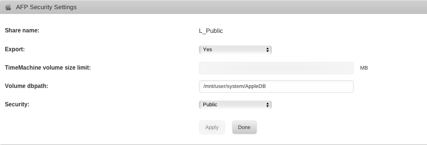

I don't know how I would "move the Netatalk database" to the cache for example.
For each share set the Volume dbpath to /mnt/user/system/AppleDB and the next time you AFP mount it the .AppleDB folder will be relocated from the root of the share to /mnt/user/system/AppleDB/<Share_name>/.AppleDB

John_M where do I find the AFP security? I don't seem to have the option that you present
To me AFP is limited to this???
never mind - got it

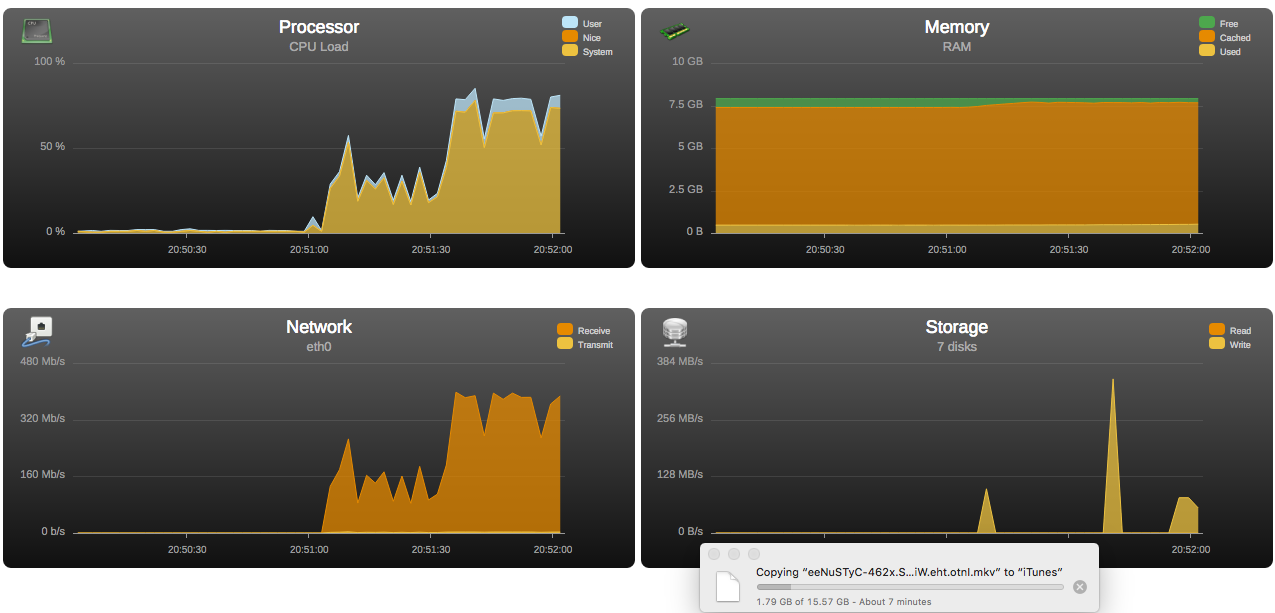

Just tried to copy files to the music folder... Speed seems good (see attached) at 500 Mb/s but it tooks minutes before it started the transfer !!!!
There's definitely a problem between the Mac and the array talking to each other... Any more suggestion??
I will try AFP again next but I'm doubtful
Do you have your drives set to spin down? Were they spun down? If so, sometimes there is a delay when the drives spin up.
Copying many small files will take a long time due to the overheads per file. How big are your music files? A few MB? Try copying a few large files instead, video files perhaps.
One thing I notice is that you have an E-350 processor, which is quite weak. I notice it's working quite hard in your screen grab. I think you could improve throughput by fitting a better NIC which would offload some of the network overhead from the main processor. Disable the onboard Realtek and fit an Intel one.

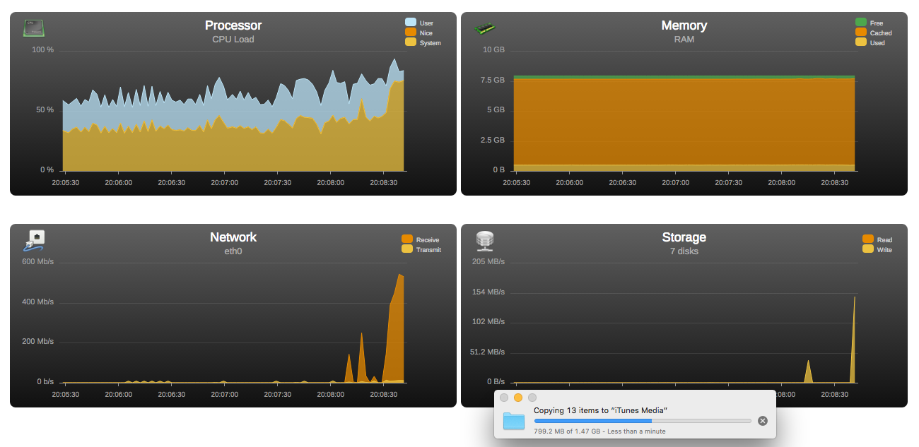

Copying a 15 Gb file using NFS...
About 400 Mb/s... I can live with that

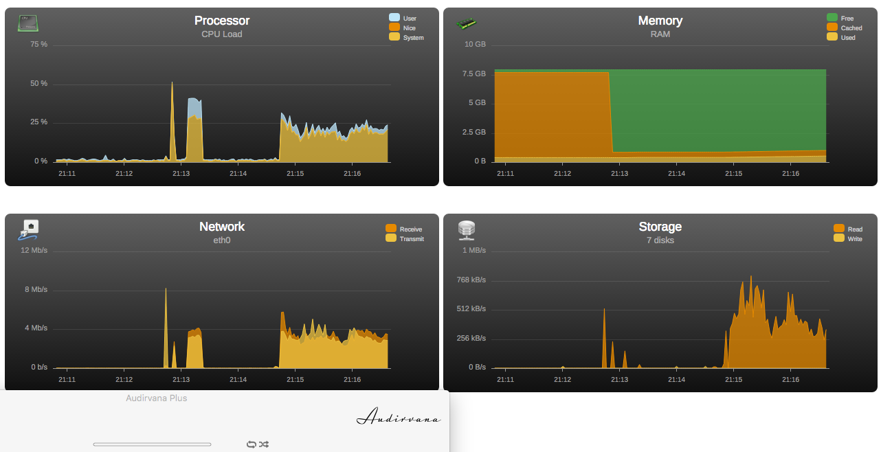

Here's audirvana trying to find the files... (hasn't started importing yet). through NFS.
