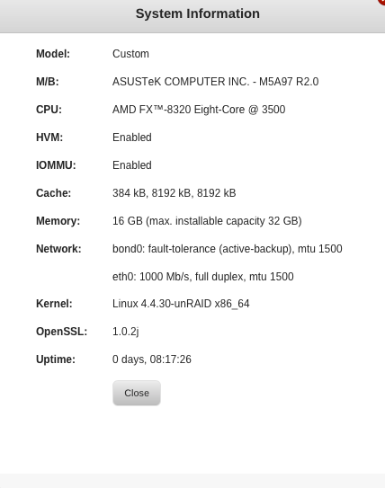

Setup:
  • unRAID 6.2.4
  • AMD 8320 FX
  • Asus F5A97 R2.0
  • Asus Radeon R9 280X DIRECTCU II TOP
  • Windows 10 Pro
Logs are below.  Another weird thing is that the logged time is not correct when I tried this time.  Last time I tried I used emulated CPU instead of passthrough and log had correct time.  Hostname has been changed to protect the innocent.
