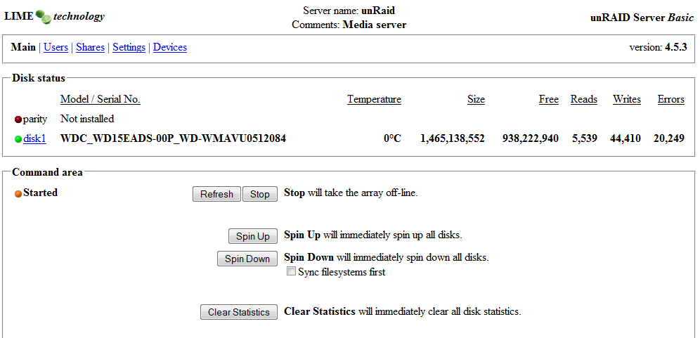

i figured out how to post the syslog file so here it is and a screenshot of the drive

Your disk is suffering from massive "write" errors (basically it is not responding to the disk controller).
It could be a bad SATA cable to the disk, a bad power cable to the disk (or a loose cable of either power or data)
Or, it could be a bad drive.
To see if the drive is responding at all, type:
smartctl -a -d ata /dev/sda
and post the output.

tnx for the reply,
i shut the box off earlier before leaving for work and i just got back home to try out the command u suggested, but when i turned the box on the unraid menu said the hard drive was missing...so i tried switching cables, still nothing. took it out to my other box and tried running the WD boot utility and that thing can't even find the drive when it boots.
so my guess, this drive is dead, the stupid thing is not even 3 months old WD 1.5TB Caviar Green....
i have another exact same drive i was planning on putting inside there after filling up the first one, i hope the 2nd one doesnt end up the same. i'll be doing an RMA tomorrow and be waiting for a new one i guess.
in the mean time im gonna empty my other 1.5TB between all my computers and throw the empty drive in there... and try it all again, hope with better results lol
