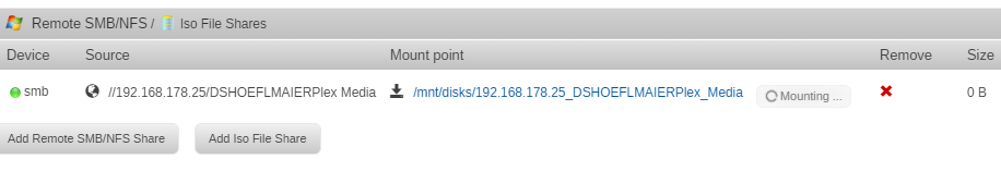

  • Added the share by inserting the ip of my nas, the username and pw used by my nas-admin-account and the destination of my nas-share(\\SYNOLOGYNAS\Plex Media)
  • Afterwards the mounting point looked like this under the tab smb-shares: /mnt/disks/192.168.178.25_SYNOLOGYNASPlex_Media)
  • Mounting this share by pressing the "mount"-button couldn't be performed.

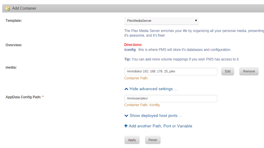

Is mounting the share by pressing "mount" necassary?(see pic 1)
How do i connect the share to the docker?
And if yes: Do i need to perform this inside the plex webinterface?

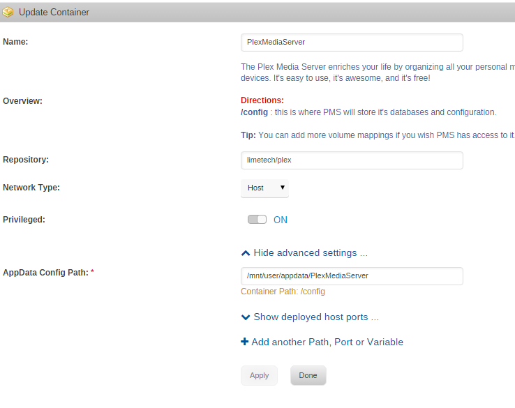

Or is it need to be done inside the docker by inserting the mountingpoint into the AppData Config Path?(see pic 2)

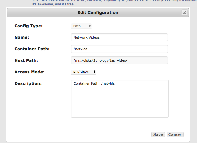

---edit to add image of what the screen looks like when you add the mounted smb connection in plex docker settings

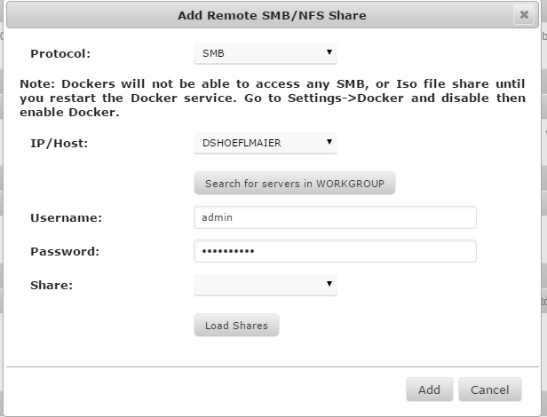

i tried to but i think the problem is then i click load shares the dropdownlist is empty.(3)
So i made something wrong in terms of configuring my synology...

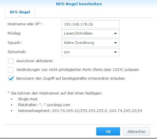

On my nas smb and nfs is activated and gave the synology-user i used as a user in (3) read and write persissions for the folder which should be shared.
Furthermore i changed under the menue nfs-permissions/edit nfs-rules the hostname/ip-address to my unraid server and allowed the access to subfolders(4). Everything else is on default.

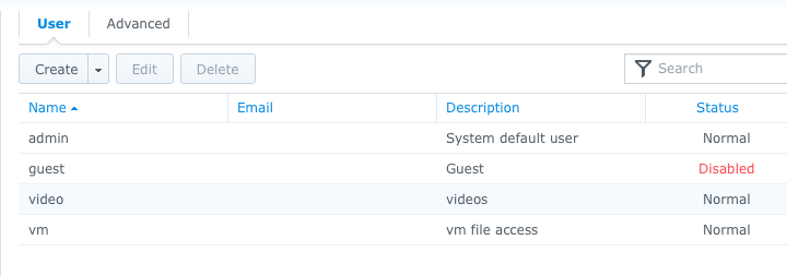

On your Synology, create a new user, ( I use "video") then only give that user permission to read or read/write where the folder(s) that your videos are stored in. (I only allow read access since plex doesn't need to write, and I don't want to accidentally delete a video using plex.)
then double check that works by using your computer to mount the files on the network via smb or nfs (whichever you have setup) in network discover or whatever you use to dig around your network.  once you know that works, then go back to your unRaid server and enter those credentials, click load shares, and your video folder(s) will be there. If your videos are in more than 1 overall source location, then each one will have to be added to the plex container settings.

now i created a new user which has read permissions for my specific nas-folder, but when i choose smb, click on "search for servers in my workgroup", choose the correct server, entering my pw & username and still nothings shows up in the list.

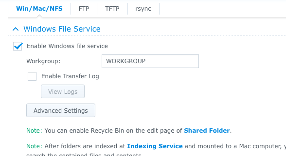

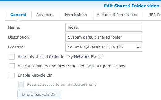

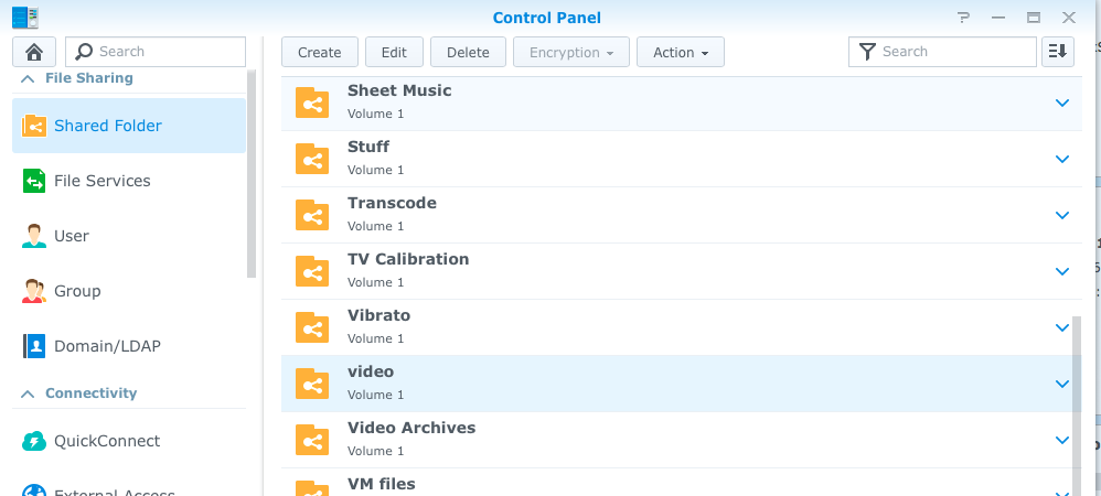

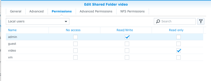

Could you screenshot some of your setting you have made to your synology concerning the share and smb? Maybe a bit crosschecking helps  :-\

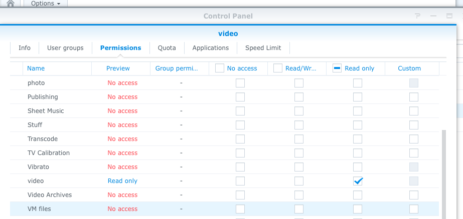

hope this helps....
a few more coming in next post.

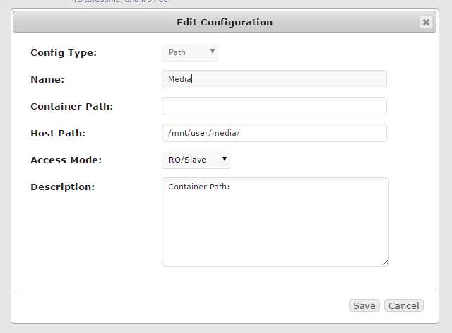

You mean i should select slave read as an option when i add a media path?
because i already tired this

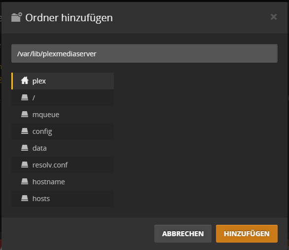

because if i want to add a normal local share to plex(6) it also doesn't show up in plex(7)
You never specified a container path.  Something like /media
So i need to put the name of my share on ther?
And what do i need to put into the container path field when i add my network-share as a path? i mean there is no share local share for that. :-\
Sry for those silly questions but i really just started out with unraid.
All volumes for docker containers require two things, the path to the unRaid folder, and the path within the container.  Its the container path that Plex actually accesses.
As an example, you've got Plex's appdata as /mnt/user/appdata/Plex and a container path of /config
If you explore within the container, you will see the contents of /mnt/user/appdata/Plex stored within Plex at /config
Same thing with your media.  Once you add the path of /media, you will see the contents of that disk at /media

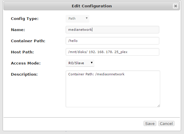

Is this implementation correct? In plex the folder hello is still empty despite i moved movie-files in there.
Did you type in the host path yourself instead of using the folder browser when you click into it?  I see a space in there /mnt/disks/{space}192.168....  I would think that it should be /mnt/disks/192.168....
i did, but i also i also used the folder browser for this :/ still not showing up

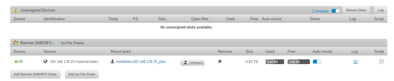

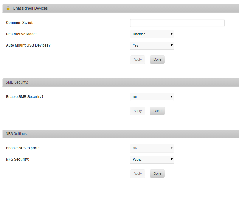

Unassigned devices setting(10)
Unassigned devices(9) for mounting i used nfs and enables nfs under settings everything else is on default.
You have to enable the share setting for SMB and/or NFS or UD will not share.  You have not set enable 'Yes' in UD settings.
