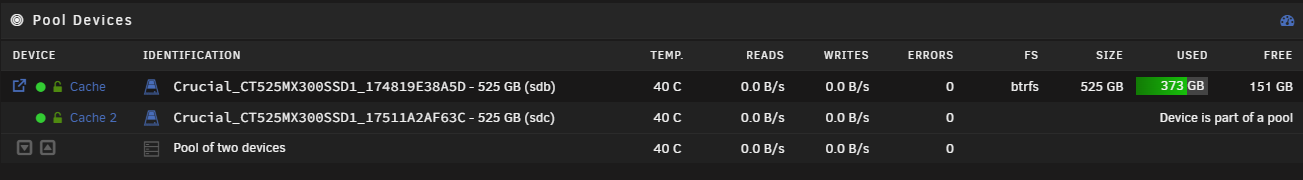

What's the process for replacing both cache drives in a btrfs pool?  Unplug a drive, plug in the new one, wait for rebuild, then repeat for the other disk?
I'm replacing both disks with 1T drives.
Basically yes, if the pool is redundant, in doubt post the diags.
16 minutes ago, jj_uk said:
What does "redundant" mean?
That the pool can work with a missing device, e.g., a raid1 mirror.
