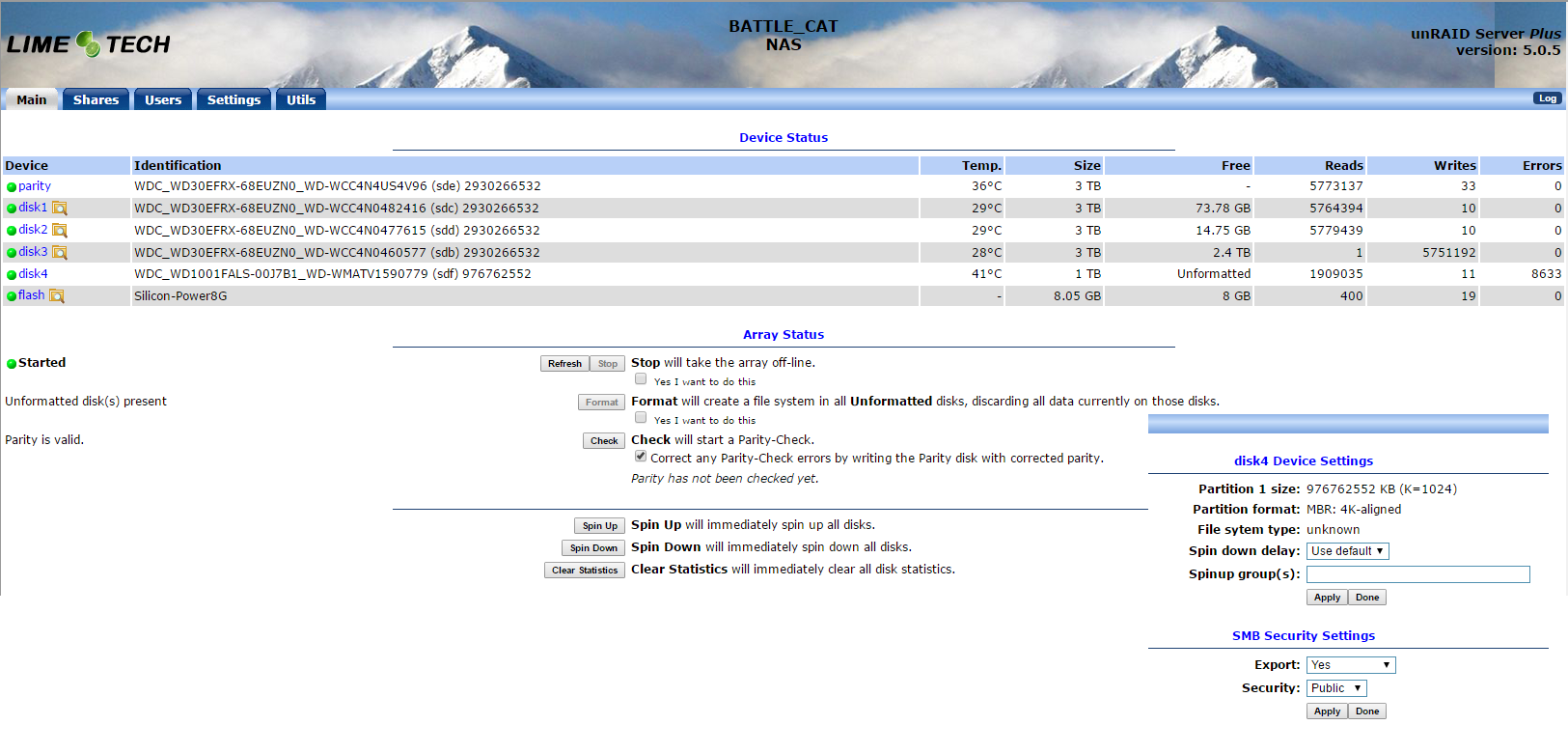

I am running unRAID version 5.0.5 and discovered an unformatted disk after a power loss (disk 4) (sdf). I booted the system once power was restored and found the disk in the unformatted condition.
Also going to add that during this time I had another disk that had previously failed (disk 3) (sdb)and I completed that replacement first using the parity swap process here - https://lime-technology.com/wiki/index.php/The_parity_swap_procedure
In general my question. Is there a way to attempt to recover disk 4 by updating the the file system? Currently it shows the file system as unknown and I am not able to use the disk.
Screenshots and syslog are attached. I have the full syslog and can provide if needed.
Is there a fix within this FAQ - 7.4 Why is a disk showing as Unformatted? I wanted to confirm with some experts before I attempt anything.

There were read errors on disk4 during disk3's rebuild, so that rebuild is corrupt, post the SMART reports, at least for disk4.

Most data on disk3 will be OK but there will be some corrupt files because of the read errors.
Disk4 is a goner:

You didn't answer my questions, and like I said most files will be OK, some (it could be only a couple or a few more) will be corrupt, by corrupt, if for example it's a video file, it may only be a little glitch during playback, but some files are corrupt for sure.
If you don't care about that and also don't care about the data in disk4 then do a new config without it, you'll need to do a new parity sync after that.
