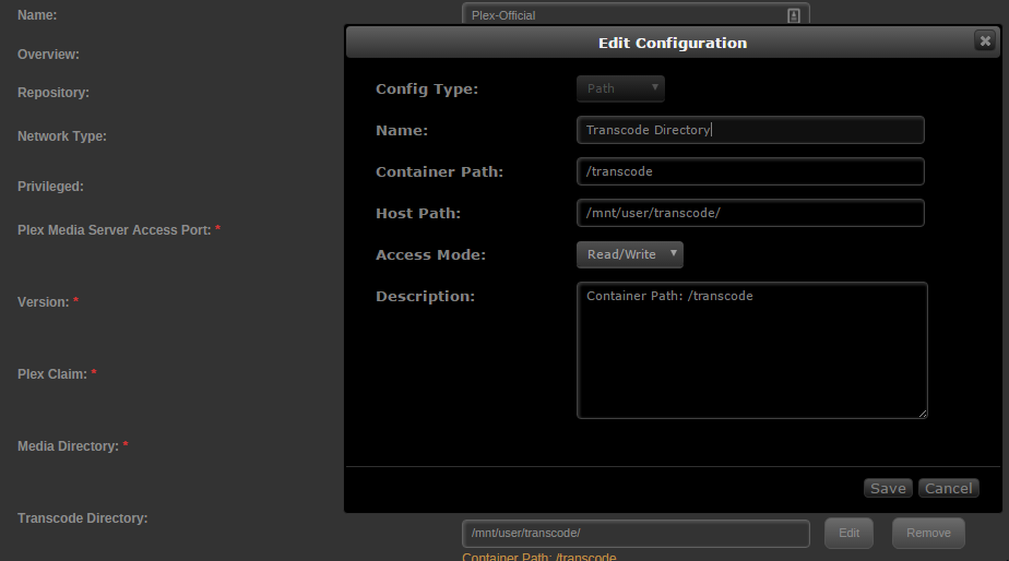

If you installed plex on to your cache drive, it should already be setup to do transcoding on that device. If you want a specific folder, you can set one up in the docker you're using and point it to the cache drive or share that is set to cache-only and then point your server transcoding directory to it.

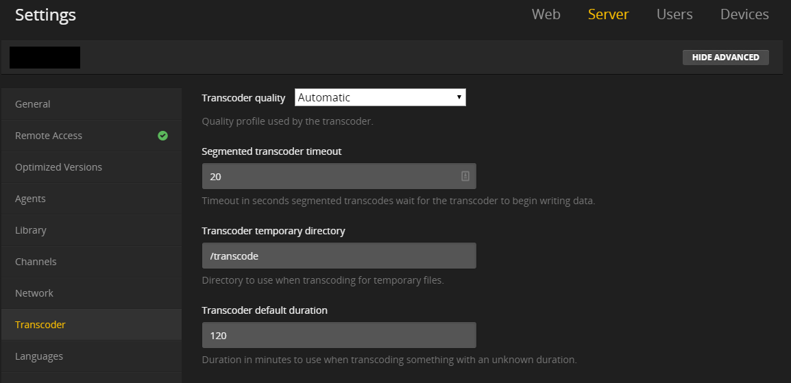

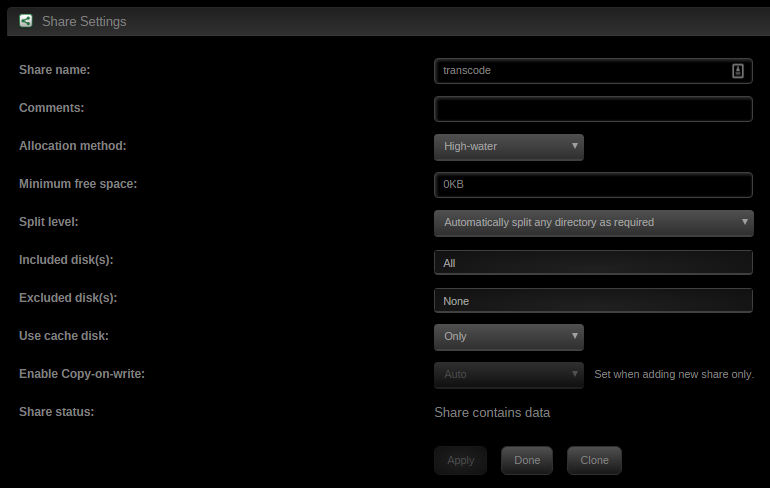

I've attached screenshots of how I have mine setup. I use a cache-only share.
