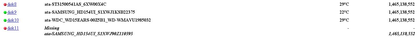

EDIT: Now I got a connection to unraid, when I removed the new drive and booted. But it seems one of my Seagates has failed?

Now I got the new HDD to show on the array, but that Seagate from the previous screenshot is still red. Should I replace it with this new one or can you see from syslog if that really is a goner?

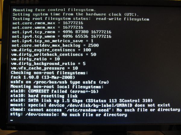

I now got it to boot to some point, but I get the message as in attached picture.
Before that I got a bunch of those errno=-16 messages for ata10.
Now THAT points to bad memory!
