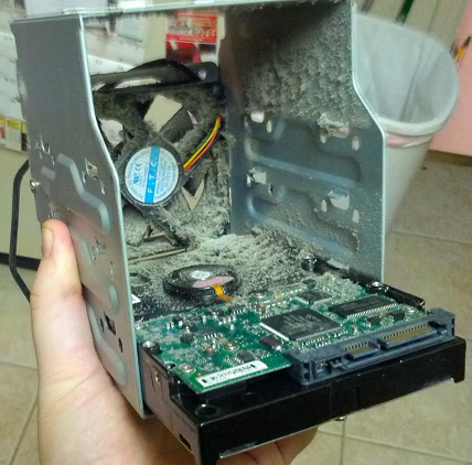

Most over heating problems are a result of dirty case, fans clogged fins on heatsinks and blocked intake ventilation posts.  All of these causes can be addressed by a good cleaning of the entire inside of the case.  It is a good  practice to clean the case about once a year to prevent any potential  problems.  Do it in a non-living area of the house (or outside) as you will be astonished at the amount of dirt and dust that can accumulate there.
Computers are very effective air cleaners.  ;D
You don't even want to touch the inside of a tobacco smokers computer.  :o
lol, completely agree, they look all yellow, oh, and the smell...    :(
I try to clean my hardware 2x a year, once in spring, once in fall because I have two things keeping my apartment dust filled: forced air and a cat.  I do that ever since a friend of mine gave me some of his old hardware (which I used to make my first unRAID build) and it was pretty freaking gross (please see attached pic).  I can't even imagine a smoker's machine - yuck.  :-\
