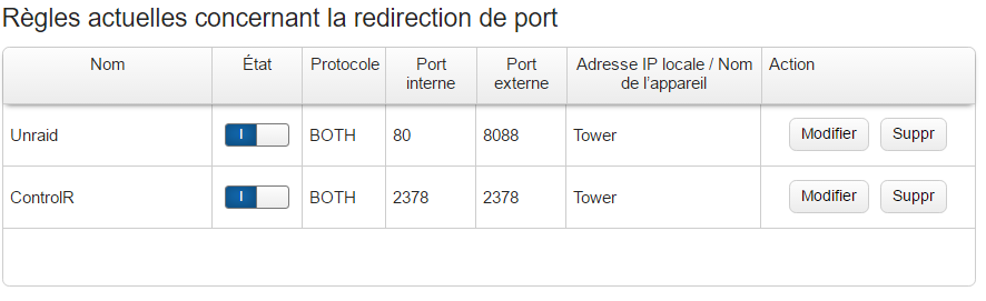

need help with controlR
Hi am trying to get controlR working with noip
if i connect localy it working great but remotely is not working
ControlR works if it can reacch the server.. So it works on your local network.. And it would work if you setup a VPN on forehand...
It would also work if you expose your unraid server to the internet..but DO NOT DO THAT... You will get hacked in hours.. Unraid is not hardened / made for that.

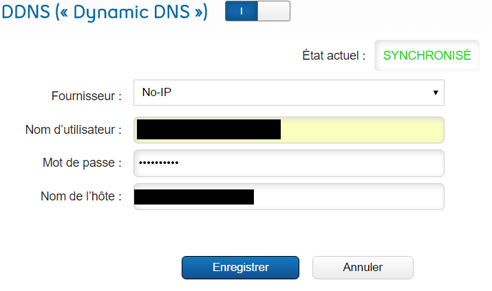

i setup openvpn with no-ip
If you have that, then connect thru openvpn to your server from your phone. After it connects controlr will work. If it does not then something is wrong with the vpn setup..
