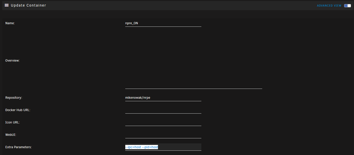

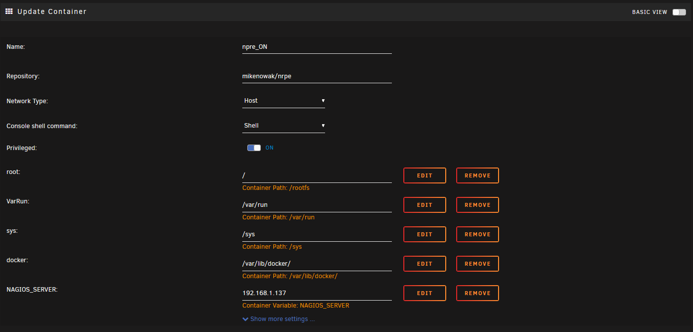

I was able to get this running using the mikenowak/nrpe docker image. I realize that this exposes the container to the whole of the system, but only /var/run is RW, and I don't expose anything over the internet.  Below are screenshots, and keep in mind when building the paths to use the R/W settings of the docker cmd line.  Also will need to add the IPC and PID parameters in the advanced view.

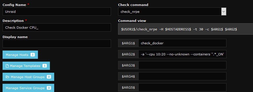

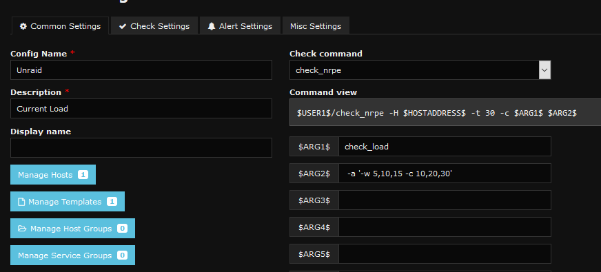

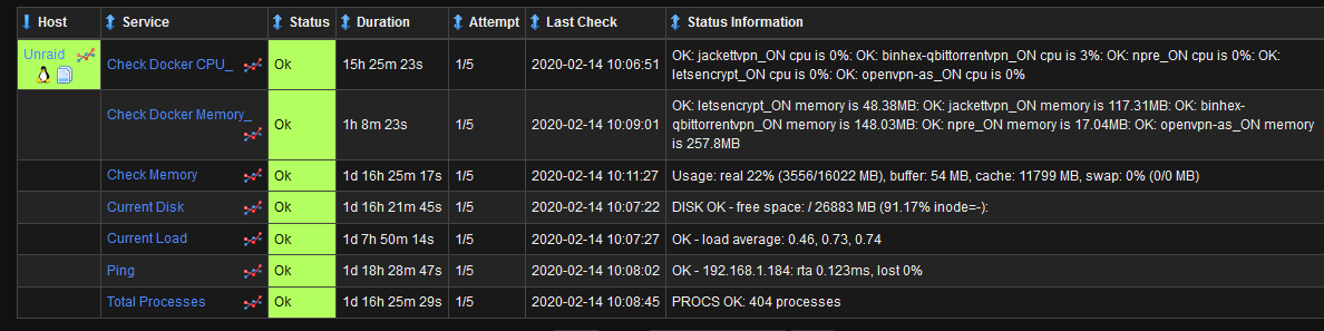

I had to get creative with the checks in Nagios, but everything I was wanting is working, graphing, etc. correctly.
docker run -d --restart unless-stopped -v /:/rootfs:ro -v /var/run:/var/run:rw -v /sys:/sys:ro -v /var/lib/docker/:/var/lib/docker:ro --privileged --net=host --ipc=host --pid=host -e NAGIOS_SERVER="1.2.3.4" mikenowak/nrpe
Example check_load:
Example check_docker cpu .  Note that I added '_ON' on the docker names for dockers that are always on and set to auto-start, so it doesn't alert out for containers that are usually down.
