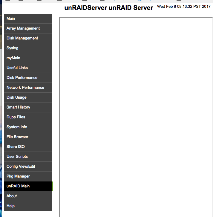

After upgrading from 6.2.4 to 6.3.0, my 'unRAID Main' web interface is blank (see screenshot). This happens in Chrome and Firefox and I cleared browser cache and tested in private mode on both browsers. I also tried killing unmenu and restarting it with no luck, but not sure if that is at all related...
The array is up and running (started automatically after upgrade) and my dockers are running.

The latest security updates in 6.3.x are probably the death knell for unmenu, since it's no longer being actively developed.
I'd advise no longer using unmenu.

oh wow, ok.
What is the best way to manage the server now? CLI only?

unMenu was never needed, and the unRAID Main web interface that you say is missing was always just a frame for the builtin web interface unRAID has always had. If you haven't hacked your go file to put it on another port you should be able to just go to http://tower or whatever you have named your server.
From your screenshot I think maybe you have named it unRAIDServer, so just go to http://unRAIDServer.

Thank you! had no clue! obviously :-) (crawling back into my hole)
