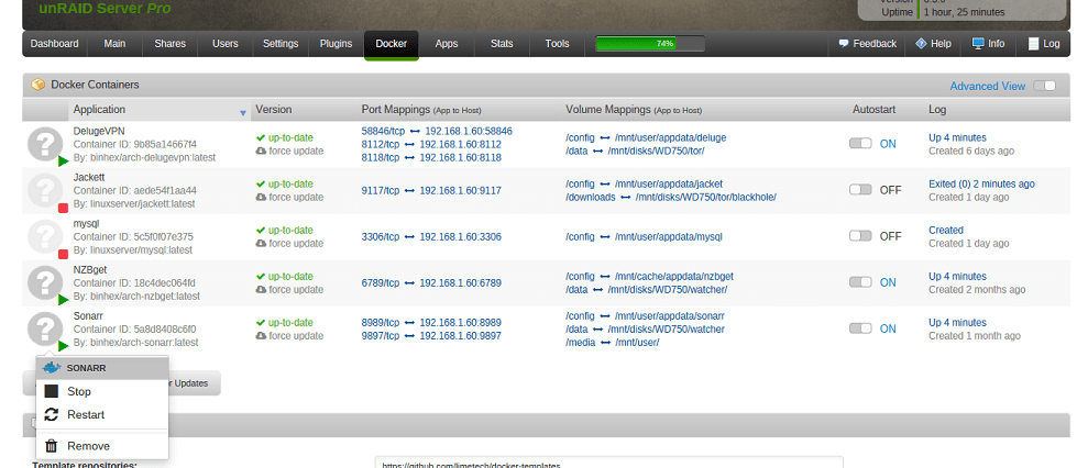

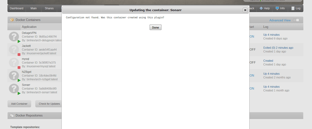

Upgraded via GUI from 6.2.4 on my secondary server without a hitch.
Primary server (also 6.2.4) hung during sync portion of update. Ended up having to pull the flash drive and upgrade manually. Parity is syncing now because of the unclean shutdown.
However, my dockers are behaving oddly. No icons for the dockers. The contextual menu doesn't show the Web UI option. Forcing an update on the dockers throws an error. I should note the dockers are actually running and accessible via browser directly.
2 screenshots and diagnostics attached.
Thanks for any help.
spock-diagnostics-20170205-1437.zip
I suspect corruption on the flash drive, as that particular docker error (Was this created with...) usually happens if the template files cannot be found on the flash drive.
Shut down, pull the stick and toss it into a desktop to run file system checks on it...
Should I cancel the parity sync then if that's the case?
And do I just check the FS via Windows?
Thanks for the quick response!
Your choice.  But if you do cancel it, start it back up again as soon as you can
Yes.
The bigger trouble is going to be if the files no longer exist and/or are corrupted.  At that point to gain full functionality back you would have to delete those containers, and re-install them and set the templates back up again to get them working again.  Any chance you've got a backup of the flash drive (either created manually or via CA Appdata Backup?)
I do have a backup from CA Appdata Backup
Yes.
Yes.
Perfect.  Check the flash for corruption (and also look at what's in config/plugins/dockerMan/templates-user)  You might have to copy from that folder in the backup to the flash drive.  *Should* bring everything back after a reboot
