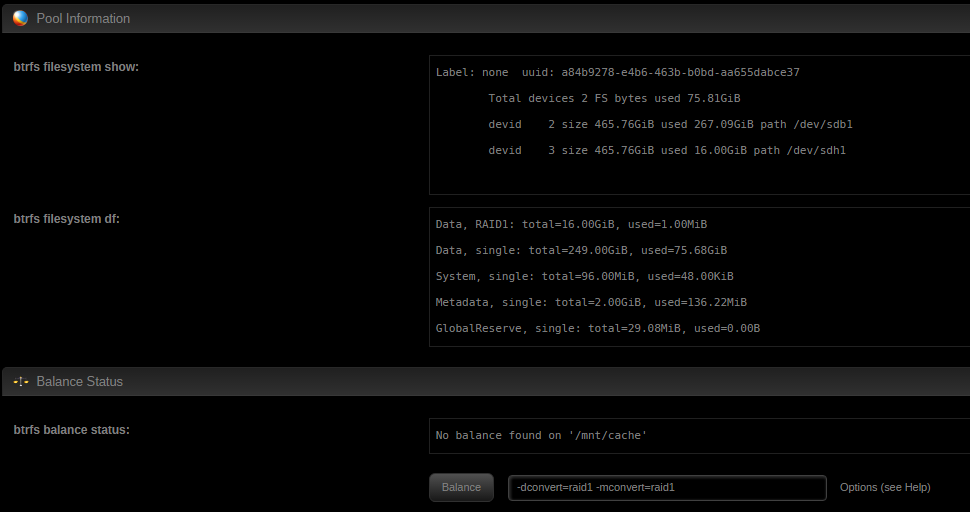

@johnnie.black - thanks for your help and patience.  I've updated to 6.3.1, powered down, disconnected cache2 and restarted.
Then started the array.  At that point, cache mounts to /mnt/cache.  So far so good.
Should just add the 2nd drive and then balance, or do you have other suggestions in this case?

I assume that the errors are leftovers, as I didn't zero stat before I removed the 2nd cache drive.  NB - the serial matches cache1, the drive that wasn't seeing errors (S21HNXAGC11924P)
The cache should auto re-balance to single, on the main click on "cache" and check if a balance is in progress, don't stop the array if it is.
Before adding the other cache device it needs to be cleared, I'll post what to do in a few minutes.
Forgot that since it's a single device now balance won't be shown on the cache page, check with:
btrfs balance status /mnt/cache
When done (when it output is "no balance found on /mnt/cache") check that cache pool is just one device and there are no missing devices:

It isn't looking like a balance started automatically.  Under Main->Cache Devices, both SSDs were listed.  When I ran blkdiscard and refreshed, Cache 2's icon turned from green to blue, so I started the array.  Now the cache details look like the attached image, with no balance seeming to be running.
Diagnostics attached as well.
tower2-diagnostics-20170215-1843.zip
It should be automatic, but run one manually by clicking on "Balance" on the cache page.
When the balance is done check "btrfs filesystem df" on the cache page, there's should be only the raid1 data profile, not like now, single and raid1 data profiles.
Also check btrfs dev stats for any errors.
