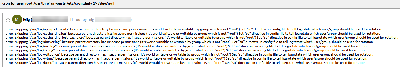

Funny that I'm back in my own old topic looking for a fix.  I just get now the same errors than @JohanSF here.  Multiple lines of errors :
error: skipping "/var/log/apcupsd.events" because parent directory has insecure permissions (It's world writable or writable by group which is not "root") Set "su" directive in config file to tell logrotate which user/group should be used for rotation.
error: skipping "/var/log/docker.log" because parent directory has insecure permissions (It's world writable or writable by group which is not "root") Set "su" directive in config file to tell logrotate which user/group should be used for rotation.
error: skipping "/var/log/syslog" because parent directory has insecure permissions (It's world writable or writable by group which is not "root") Set "su" directive in config file to tell logrotate which user/group should be used for rotation.
error: skipping "/var/log/vsftpd.log" because parent directory has insecure permissions (It's world writable or writable by group which is not "root") Set "su" directive in config file to tell logrotate which user/group should be used for rotation.
error: skipping "/var/log/wtmp" because parent directory has insecure permissions (It's world writable or writable by group which is not "root") Set "su" directive in config file to tell logrotate which user/group should be used for rotation.
error: skipping "/var/log/btmp" because parent directory has insecure permissions (It's world writable or writable by group which is not "root") Set "su" directive in config file to tell logrotate which user/group should be used for rotation.
Didn't change anything, seems to have started 1 or 2 weeks ago.
