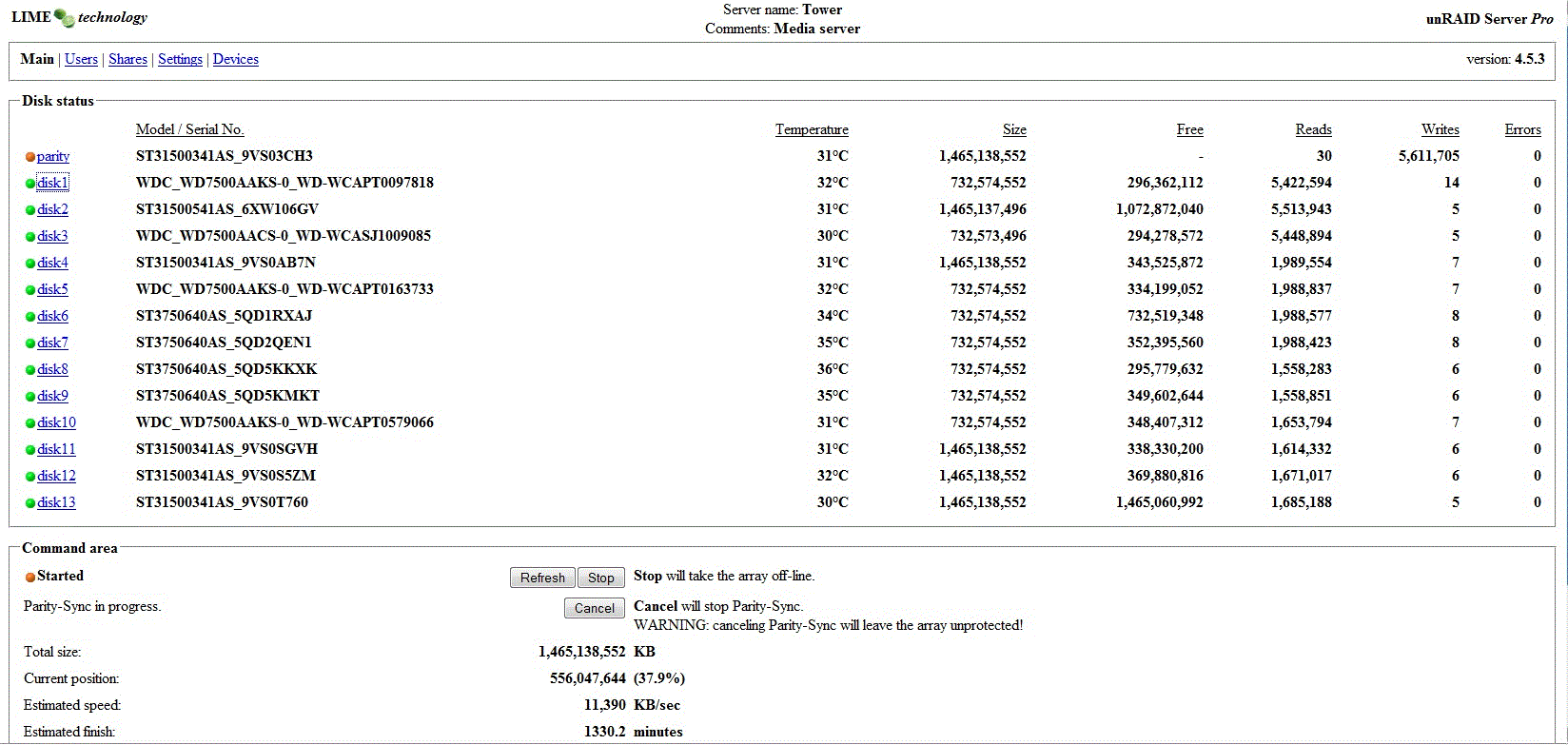

I haven't really visited this forum all that often, mainly because my unRAID array has been up and running fine for the past two years or more.  I just recently had some issues that I'm working out and after reading some of these threads I'm starting to feel that my array isn't running as well as I originally thought.  Here's a screenshot of my array while it's rebuilding parity.  As you can see, the estimated speed is well below what most others are reporting for their arrays.

14 hard drives shown in the attached image

While it is true that it is probably the quantity of your drives sharing the PCI bus that is slowing your parity check speeds, there could also be a single drive having problems.  The parity check cannot go faster than the slowest drive.  I would check the syslog for drive errors, and SMART reports for all of your drives, to make sure all are healthy.  Cable errors also can slow the communications way down, without ever failing a communication or causing read or write failures or any other obvious and very visible error.  They would however only be visible in the syslog.  That 11MB/s in your pic is very possible with a drive or 2 running at UDMA/33, slowed because of cable issues.  (Cable replacements are much cheaper than controller replacements!)
