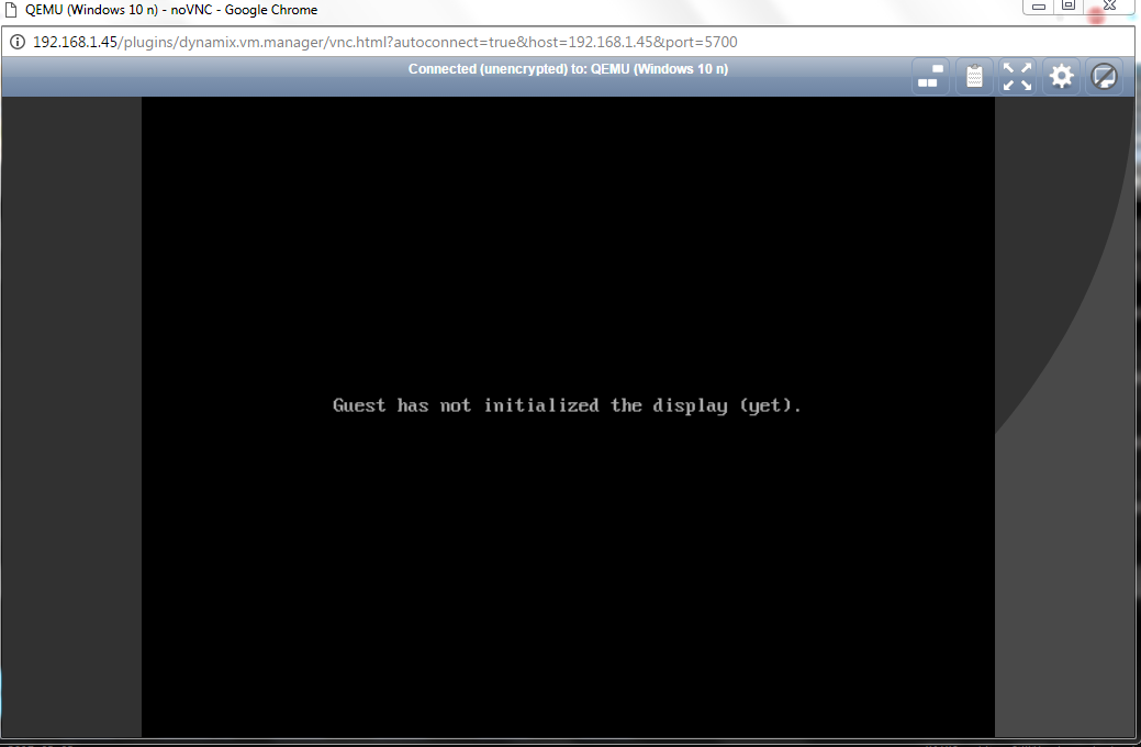

3 days ago i rebooted my system and from that moment all my VMs started acting weird.
They dont start at all when a PCI device is in the configuration (USB controller, PCI GPU, Intergrated Audio Card).
If i start the any VM without any PCI device in the configuration and with VNC it works like a charm.
There are no errors in the log.
2017-02-07 08:11:00.791+0000: starting up libvirt version: 2.4.0, qemu version: 2.7.0, hostname: Tower
LC_ALL=C PATH=/bin:/sbin:/usr/bin:/usr/sbin HOME=/ QEMU_AUDIO_DRV=none /usr/local/sbin/qemu -name 'guest=Windows 10 n,debug-threads=on' -S -object 'secret,id=masterKey0,format=raw,file=/var/lib/libvirt/qemu/domain-2-Windows 10 n/master-key.aes' -machine pc-i440fx-2.7,accel=kvm,usb=off,dump-guest-core=off,mem-merge=off -cpu host,hv_time,hv_relaxed,hv_vapic,hv_spinlocks=0x1fff,hv_vendor_id=none -m 24576 -realtime mlock=off -smp 8,sockets=1,cores=4,threads=2 -uuid 3d948a60-c575-1ce6-3fdf-9f17f422fe96 -no-user-config -nodefaults -chardev 'socket,id=charmonitor,path=/var/lib/libvirt/qemu/domain-2-Windows 10 n/monitor.sock,server,nowait' -mon chardev=charmonitor,id=monitor,mode=control -rtc base=localtime -no-hpet -no-shutdown -boot strict=on -device nec-usb-xhci,id=usb,bus=pci.0,addr=0x7 -device ahci,id=sata0,bus=pci.0,addr=0x5 -device virtio-serial-pci,id=virtio-serial0,bus=pci.0,addr=0x6 -drive file=/dev/sdc,format=raw,if=none,id=drive-sata0-0-2,cache=writeback -device idio-pci,host=00:1b.0,id=hostdev0,bus=pci.0,addr=0x8 -device virtio-balloon-pci,id=balloon0,bus=pci.0,addr=0x9 -msg timestamp=on
Domain id=2 is tainted: high-privileges
Domain id=2 is tainted: host-cpu
char device redirected to /dev/pts/0 (label charserial0)
2017-02-07T08:18:34.215810Z qemu-system-x86_64: terminating on signal 15 from pid 23552
2017-02-07 08:18:34.816+0000: shutting down, reason=destroyed
I attach all logs and ascreenshot.
Im on 6.3.0
Thanks In advance.
