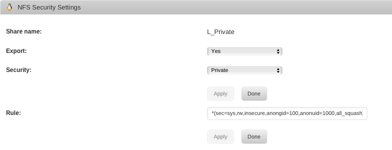

You're trying to export an NFS share with security settings and the system is failing to parse the rule you have set. Go to Shares in the web GUI and click on the Media share. Scroll down to NFS Security Settings and edit the Rule. The one you have is wrongly formatted. One that works for me looks like this:
*(sec=sys,rw,insecure,anongid=100,anonuid=1000,all_squash)
