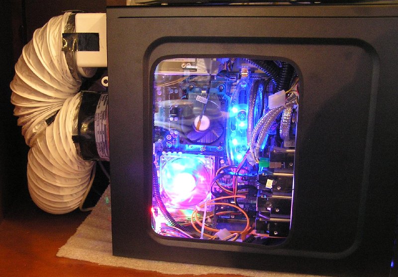

That's the case I'm using right now.  I have 4 drives currently no problem.  I cut out the stamped grill both front and back.  It comes with the rear 120mm fan which is a nice quiet fan so I left it in.  I added a 120mm in front of the drives and used cardboard and tape to box in the lower section nothing fancy.  Good air flow.  I got it for $19.99 + free shipping in Dec.
It's in a cabinet with a couple other small servers.  I vent the hot air out the back.
@queeg:  Those air ducts are killing me!  ;D  Looks out of this world.
Gives a kind of SciFi look I guess.  :D  Works really well at keeping the heat out of the cabinet.  Works nicely in a closet as well.
