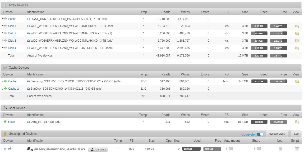

Currently I'm running the Crashplan Docker and intend to use others. I also intend to run a Win10 VM on the server eventually. I have successfully got the system, appdata and domains shares to reside on the cache pool in "Prefer" mode.  The isos share writes to the cache pool but resides on one of the array data disks (i.e. "Use cache disk" set to "Yes").  I have a 480GB SSD mounted in Unassigned Devices and from what I've read, it sounds like this is the preferable place to store my Dockers and VMs rather than take up space in the cache pool.  However, I can't figure out how to get the various shares onto the unassigned SSD.

There is no need to run VMs or Dockers from an Unassigned disk unless you have insufficient space on the cache disks.  The commonest use in that case is to consider putting VM vdisks on an Unassigned disk as they can be large files.
You cannot move user shares to an Unassigned disk - shares can only reside on the array disks and the cache disk.
You CAN set up an Unassigned disk to be a share in its own right - but in that case the share covers a partition on the disk.  Most people would have an Unassigned disk as a single partition.
I would just put it in cache, especially since your cache pool is already pretty big. It is much simpler to let unRAID manage a cache pool with its user shares than to add the complications of Unassigned Devices, unless you actually know why your specific use case would be better with Unassigned Device.
You may have seen some threads talking about using Unassigned Device for these things, but probably most people aren't doing it that way so don't talk about it, and some of the people who are doing it that way don't know why.
See the unRAID V6 FAQ sticky for how to work with your cache pool.
