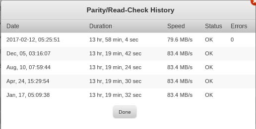

Upgraded another server to 6.3.1 (from 6.2.4) => upgrade went fine, but parity checks, which had been VERY consistent for the past year (never more than 18 seconds difference), just got 39 minutes longer.

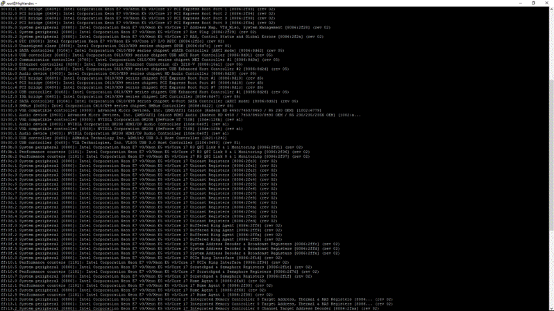

Thanks - using DDU did the trick.
Re lspci not working - it was truncating the code for my audio card so I couldn't stub it - it never used to truncate before.
Is the truncating happening in the webgui or command line?
Both - checked with putty as well
I haven't installed 6.3 yet  ::) So can't check here, but on 6.3 RC I don't see truncation.
How do you connect to your server and is the window wide enough to show everything?
viewing full screen - putty screenshot attached.
I used to be able to see the details in putty, so this is a recent change (2017) I think
