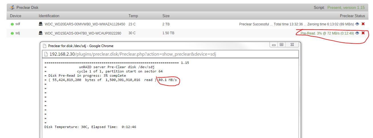

I installed the plug in and almost done with my first preclear..
So far it works great except for a discrepancy in the MB/s between the web GUI and the Preclear log window.
The web GUI shows 74 MB/s and the Preclear Log shows 123 MB/s.
This difference has been consistent no matter what the speed is.
You mean the e-mailed reports and such?  the e-mailed reports will calculate based on time elapsed and bytes done. the gui uses the instantaneous value, iirc...
No, both are from the web GUI, no e-mails involved. One on the preclear web page that come up when you click on the plugin icon from the plugins page and the other from the log window on the web GUI that opens when you click on the "eye" icon on preclear plugin page.
You mean these two values?  I could just be how often one refreshes vs the other..  The plugin author will have to comment on that.
Jim
Yes, that's it. They both update/refresh often and I would think that over a 28 hour period that sooner or later they will match fairly close.
Maybe the web keeps a running average where the script window is an instantaneous??
Both speeds are calculated by the preclear script.
The one displayed in the window is the average speed between two screen updates, while the one displayed in the GUI is the overall average speed since the start of the operation.
