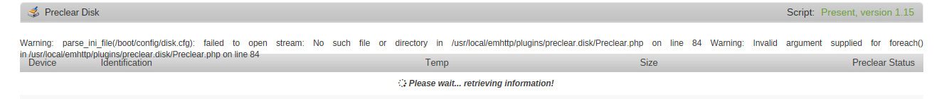

When I bring up the preclear Disk utility I get this error on the top of the page
Warning: parse_ini_file(/boot/config/disk.cfg): failed to open stream: No such file or directory in /usr/local/emhttp/plugins/preclear.disk/Preclear.php on line 84 Warning: Invalid argument supplied for foreach() in /usr/local/emhttp/plugins/preclear.disk/Preclear.php on line 84
And it hangs on 'Please wait... retrieving information!'
Pic included and log with it.
Brand new installation?  Syslog doesn't look like you've got any drives assigned at all, and apparently preclear doesn't like that fact.
Thanks Squid...lol...never mind me i'm a boob..really late here,  good excuse as any  :)

Truth be told, the plugin should work, as that use case is quite possible.  Gfjardim / Joe? probably just never thought about it.
So its telling that there is no disk.cfg, I have installed the disks, rebooted the system , assigned them and unassigned them...what do I do now?
I am still getting
I am still getting
When i install it on my second server
Okay so I got it, I have to assign and actually start the array first then unassign them to get it to work.
