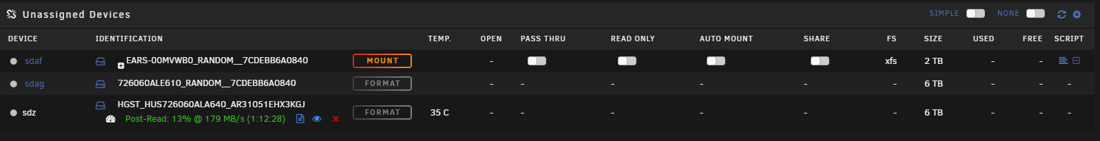

I think I'm having an odd problem with the plugin, or I'm doing something that completely isn't supported and don't realize it...

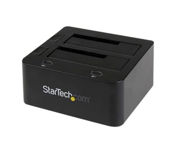

I have a 2 bay external USB 3 sata desktop thing.  Something like this but a different brand.
I have several drives I wanted to test and preclear.  I put 2 in that unit, one 2TB drive and one 6TB drive.

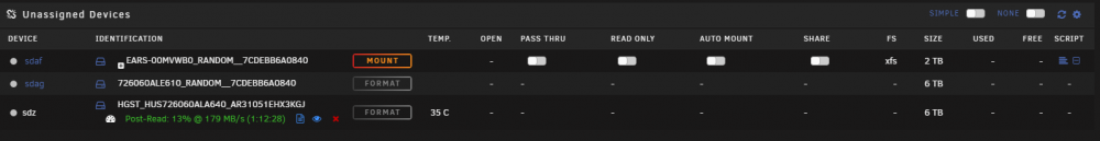

They detected in unassigned devices.  Though.... if the end of the names seem strangely familiar.
(The 3rd disk there that is preclearing is a 6 TB connected internally (was connected and preclearing before connecting this USB desk station thing)

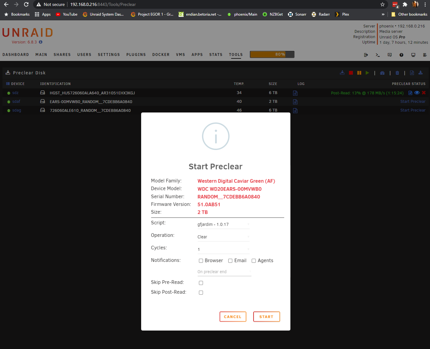

I went into Tool > Preclear > and started to preclear the 2TB drive but when I did the link on the right side to preclear the 6TB drive was no longer there.  I stopped the preclear on the 2TB drive Now when I click the preclear link on the lower 6TB drive (the one not already running that is in the USB encloser) it reports as the 2TB drive.
Any ideas whats going on here I'm more than a bit confused.

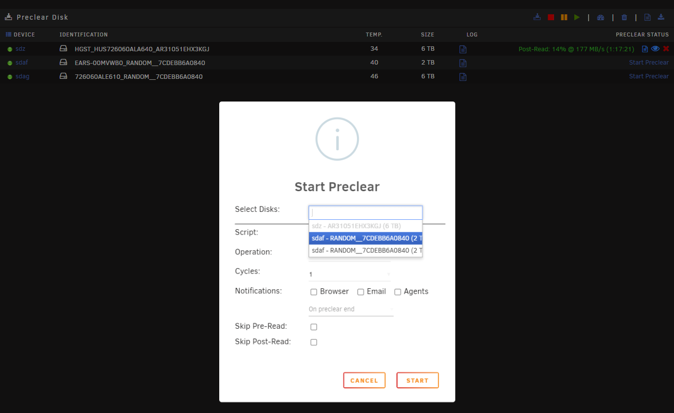

If I try the option in the top right for "start multiple sessions" it lists the sdaf (2TB) drive twice...
Messing around with it I flipped the disks in the external USB desktop thing.  The Identification strings for both drives in unassigned device now appear to be the S/N of the 6TB drive.  And the issues above are now the same but for the 6TB drive now instead of the 2TB drive.
Maybe my USB enclosure is just a kinda garbage and doing some wacky stuff with drive identification?

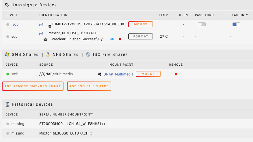

OK, I've used the Preclear plugin successfully to preclear a 300GB Maxtor drive. The precleared drive shows up under Unassigned devices. There's a button to format it, but it's grey and has lost its link. Below is a list of Missing drives and the Maxtor appears there.
Can anyone tell me what's going on here?
Chris

29 minutes ago, bidmead said:
button to format it
Are you intending to use it as an Unassigned Device?

You have to click on that red X to clean your preclear session to format your drives.
Enviado de meu SM-N970F usando o Tapatalk
Thanks for getting back to me.
Ok, I've done what you suggested. The red X disappears and I've refreshed the browser page. But there's no change. The format button is still greyed out and the drive still appears as both unassigned and missing.
I intended to add the drive to the array.
Sent from my CPH1907 using Tapatalk
No need to format then, but if you still want to just read the first couple of posts in the Unassigned Devices plugin thread and you'll find the answer.
Ah, OK. Thanks, JorgeB. That makes sense. If I'm going to add the drive to the array (which is my intention) I don't need to format it at this point because the act of adding it will present the formatting opportunity.
What I'm less sure about it why the drive is being declared as "missing". As a complete newbie I'm not clear what UnRAID thinks this drive is missing from. Not missing from the array, because it was never in the array. And not missing from the list of unassigned devices because it's still showing up in that list.
