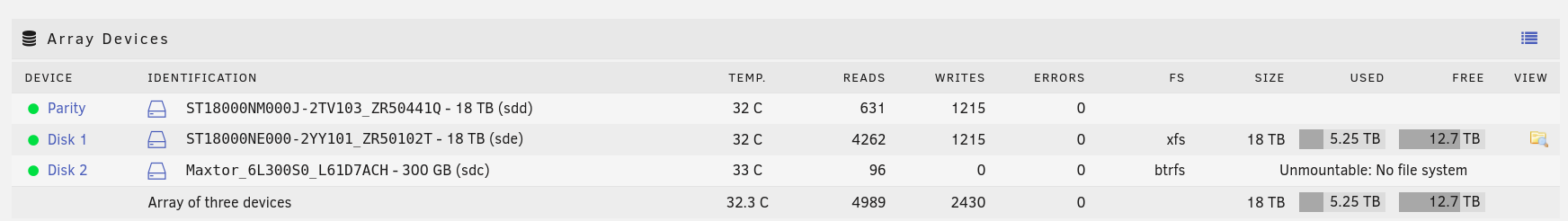

7 minutes ago, bidmead said:
In the screenshot I posted.
It's missing from the UD devices plugin, not the array, you can delete that on the right side.
Thanks again, JorgeB. That's really helpful.
OK, I've now set the Maxstor format to btrfs and successfully added it to the restarted array.
More confusion here, though, as under Main, the drive file system is reported as btrfs but is also being reported as "unmountable, no file system".
Apologies for the repeated requests for handholding. The UnRAID WebGUI is magnificently detailed and the clarity of the physical layout is exemplary (QNAP and Synology please note). But the logic is occasionally defeating me.
Chris
You need to format it, next to array start/stop button.
I feel we're nearly there, but I remain defeated by my ignorance. On my WebGUI Dashboard, the icon next to the array start/stop button does a reboot.
Chris
On the main page, not the dashboard.
Got it, JorgeB. Your real-time responses very much appreciated. Many thanks for your help.

3 hours ago, DougCube said:
Sounds like something went wrong with the preclear. Clicking the X should have no impact. Once the preclear is done, even before the post-read, there would be a signature written to the drive that Unraid picks up on when you later add it to the array so that it doesn't have to clear it again.
I've never heard of this happening.
Everything went fine, I received email saying so, and I also checked the logs.
== invoked as: /usr/local/sbin/preclear_disk_ori.sh -M 1 -o 2 -c 1 -W -f -J /dev/sdf
== WDCWD120EDAZ-11F3RA0 XXXXXXXX
== Disk /dev/sdf has been successfully precleared
== with a starting sector of 64
== Ran 1 cycle
== Last Cycle`s Zeroing time : 20:27:01 (162 MB/s)
== Last Cycle`s Total Time : 43:37:02
== Total Elapsed Time 43:37:02
== Disk Start Temperature: 30C
== Current Disk Temperature: 30C,
2 hours ago, Zorlofe said:
I wish I had noticed this post earlier, lol. Thank you for pointing this out. I had the same problem as the previous poster and that would have saved me some time on a 12TB drive.
That means preclear doesn't do anything when adding new drive? That's strange. I thought Unraid should pickup that the disk is precleared and go straight to syncing parity. I didn't format the disk as trurl wrote, just preclear.
Edited by Tomr
Unraid does not need to do anything to parity when you add a 'clear' disk as since it is all zeroes it does not affect parity.   It is at this stage that you tell Unraid to format the disk (which only takes a few minutes) and as you format the disk (which is a form of write operation) then Unraid will be updating parity to reflect this format operation.
Yeah that's where I screwed up. I formatted after pre-clearing instead of letting Unraid do it..
The thing is I didn't tell it to format anything. I just added new slot, started the array and it went up straight to cleaning it. Now that I think about it, it's prob because my array is encrypted.
Encryption is irrelevant to this as parity runs at the physical sector level.   Unraid will go straight into clearing a disk when you add it any time it does not recognise a ‘clear’ signature as being present on the drive.
I wonder why it didn't recognize the correct signature then.
