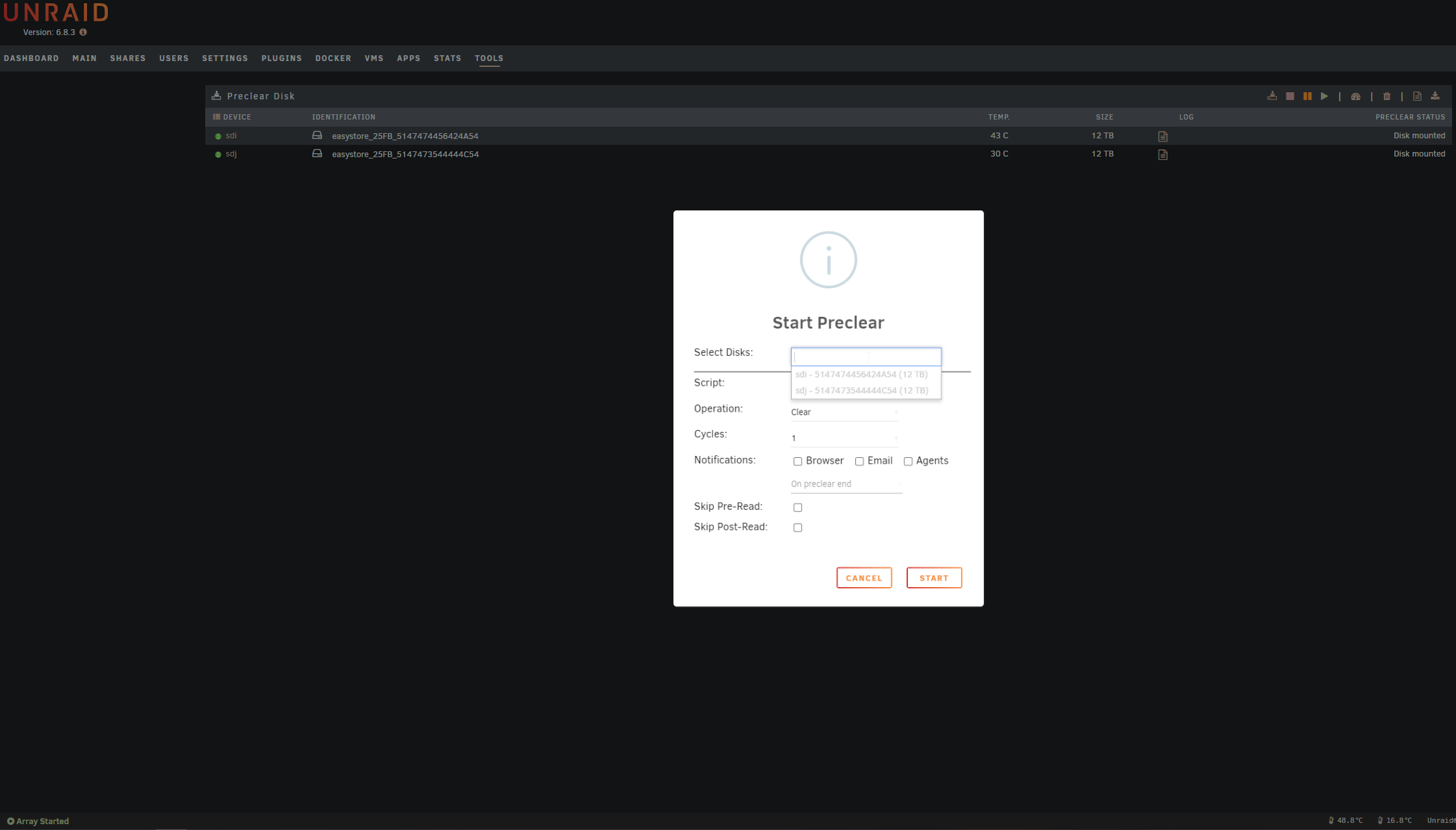

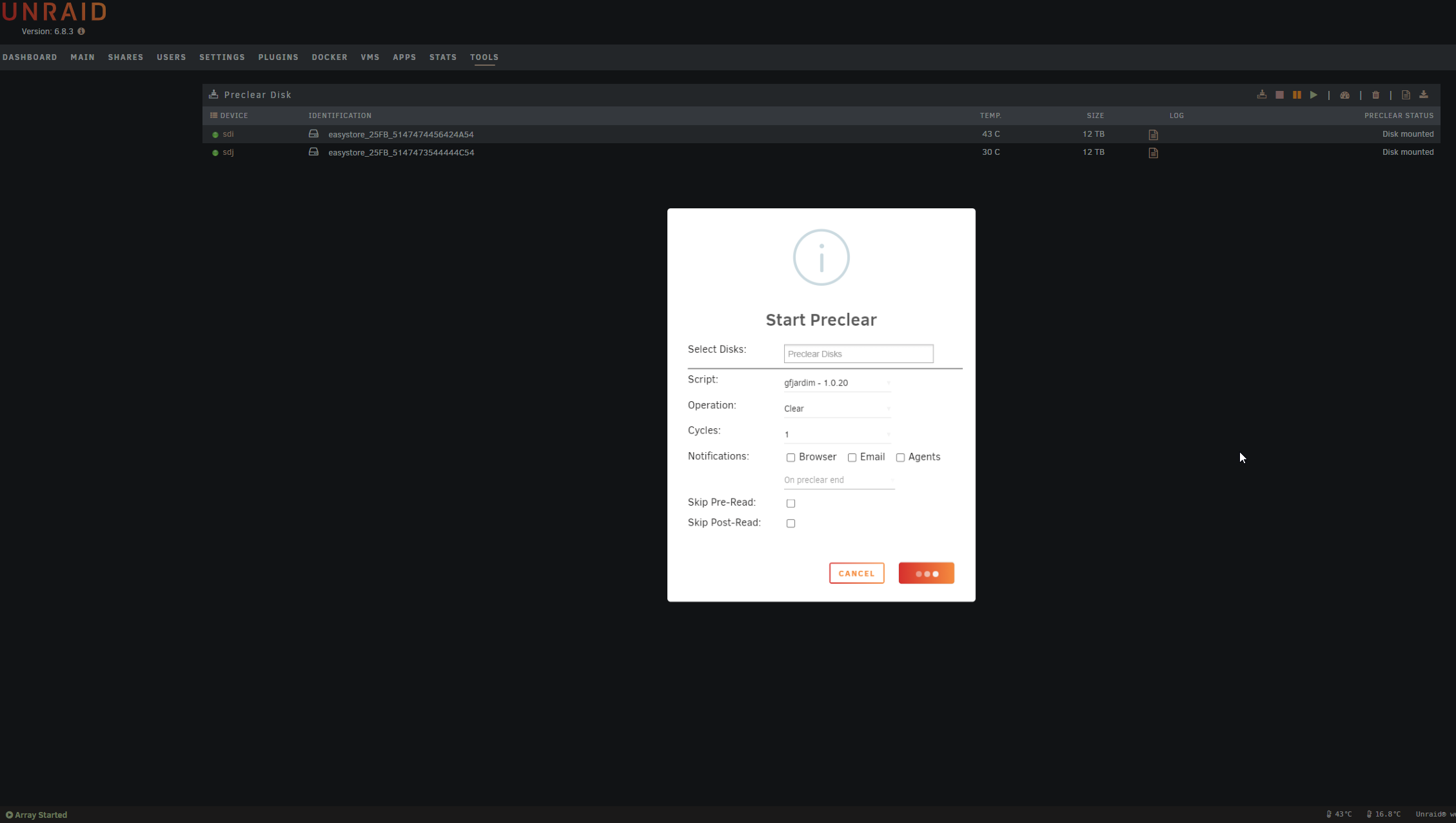

I just bought two Western Digital Easystore 12Tb HDD. I haven't taken them out of the external enclosure yet because I am out of SATA ports on my motherboard. I have them plugged into the back of my motherboard as regular USB 3.0 devices. Previously, I have successfully precleared drives with them directly plugged into the SATA port and a USB 3.0 port so I know this is something that can be done. I currently have one drive part of the array as a USB device and everything has been working fine.
I am still on the trial version of unRAID 6.8.3. I'm running Preclear Disk version 2021.01.03, Unassigned Devices version 2021.01.16b, Unassigned Devices Plus version 2021.01.24.
I load up the Preclear plugin and on the rightmost column Preclear status for both drives shows up as "Disk mounted" so I click "Start Multiple Sessions."
The first issue is that the box that says "Select Disks: Preclears Disks" is a gray font and if I click on the box for the drop down menu, then the 2 drives are also gray. I tried this with only one disk plugged in and it's the same gray font but now with only one drive showing. I can't recall exactly but I think on my previous runs, they were a black font.
1554791495_unRAIDPreClearIssue2021-01-2819_44_31.thumb.png.c5d3beb92781c3e82ffd569fe9820675.png
I then click "START" button which turn it into 3 white dots that light up gradually like a loading logo. That button stays like that for about 30mins without anything happening or showing me the progress. I have tried this with both gfjardim - 1.0.20 script and Joe L. - 1.20 script with the same results.
214892743_unRAIDPreClearnotstarting2021-01-2819_44_31.thumb.png.60a62e5cfe22882f2668c8d92e622116.png
Don't pre-clear the WD drives in the enclosure. I know from experience it won't work and you will have to do it again when you add them to the array. Unless you plan to keep the drives in the enclosures while they are in the array that is.
If you plan to run them off USB in the array I would highly recommend figuring out a way to get some more sata ports (time for an HBA it sounds like). USB is not nearly as reliable as sata and it only takes a drive dropping out for a second to require you to have to rebuild the entire disk.
You can get HBA's on ebay for less then $50 last I checked.
Far as the issues with the plugin itself, can't help you there.
If it's marked as mounted, then it's mounted. Depending the settings in Unassigned Devices, it auto mounts USB disks when plugged.

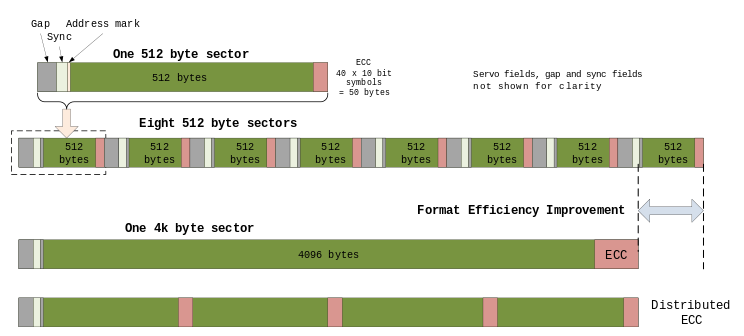

On 1/26/2021 at 2:58 PM, mgutt said:
I don't think the second part is really useful. It maybe sounds logical, but finally it misses a simple part: A new disk has already zeros on it. So writing zeros to a disk which has already zeros on it, verifies nothing because writing only zeros means demagnetizing all sectors which are already demagnetized. Conclusion: You don't know if a sector could really contain data as you never tested writing / magnetizing.
Your assumptions on magnetic media are wrong. The information on a disk is not coded into magnetised / demagnetised spots, it is coded into transitions of magnetisation with opposite polarities. The read heads detect magnetic flux changes, not the magnetisation itself. Also what is written are not the bits that the disk driver hands over to the drive. The data coming from the driver gets re-encoded in a way that optimises several parameters, e.g. number of transitions for clock recovery, influence on neighbouring spots, error correction. How it is done on a given drive is the secret sauce of its manufacturer, but whatever bit patterns you send to the drive, what ends up on the disk is something different and the spots on the disk platter will always get magnetised with one polarity or the other. For disk surface testing it does therefore not matter much, whether you write zeroes or random data. For stressing the mechanical elements and forcing early failures of marginal drives it doesn't matter either. For pre-clearing a disk you obviously need to write zeroes. There are some scenarios, e.g. a controller circuit on the drive having issues or a fake SSD with less capacity than advertised, where using a pseudo-random sequence would be far superior to using zeroes. But in that case you would need reproducible pseudo-random sequences so that you only need to store the seed between write / read and not the sequence itself. Your proposal to create a block of random data and repeatedly write / read that block would not detect issues with addressing. I do however think that those scenarios are beyond the intention of this plugin. There are already tools for that kind of tests.
Pre-clearing was very important when Unraid was not able to clear a disk while keeping the array available. This has changed, but the plugin can still be used to stress-test a drive before adding it to the array.
Ok, I read this article. Now I understand the principal.
But if you write zeros everywhere, it should use only one polarity on the complete surface.
Why not? I would create the block, calculate it's CRC hash, write the block, read the block and compare the CRC before/after.
This approach was needed before, when disks controllers lacked advanced firmware functionality. Like you said, if a block is read and it doesn't check against its CRC, the firmware tries to recover the data from its CRC, and if it fails, it will mark the sector as a pending sector. When you write the sector again, it will store the value in a new spare sector designated by the firmware to occupy its place, and mark the old one as a reallocated sector. That's why you don't need fancy random patterns to test modern disks.
That's why we read the disk in the pre-read, to force the disk to detect defective sectors and mark them as pending sectors. After that we write to the disk to force the firmware to map new spare sectors to the pending sector's place and mark them as reallocated sectors.
No, the data you write is encoded for two reasons: guarantee a minimum of transitions for clock recovery (see RLL codes, https://en.wikipedia.org/wiki/Run-length_limited) and modern error recovery algorithms (https://en.wikipedia.org/wiki/Low-density_parity-check_code, https://web.archive.org/web/20161213104211/http://www.marvell.com/storage/assets/Marvell_88i9422_Soleil_pb_FINAL.pdf)
In other words, there will always be a lot of flux reversals / polarity changes regardless of what exactly you write.
Yes, but assume you have an address line defect in a higher address line (or a fake SSD with only 128 GB instead of the expected 2 TB). You would write a block, e.g. 1 GB and successfully read back from there. All your tests would be successful. During your tests you would never notice, that when you assume to write into the second 128 GB you actually overwrite the first. Only when you write the whole disk first and then start reading back would you detect this kind of defect / cheating. Since you are unlikely to have enough RAM to keep a copy of written random data for the whole disk, you need a pseudo-random sequence as a source for the written data. When you read back you can then just use the same generator and seed and generate the sequence again for comparison with the read data.

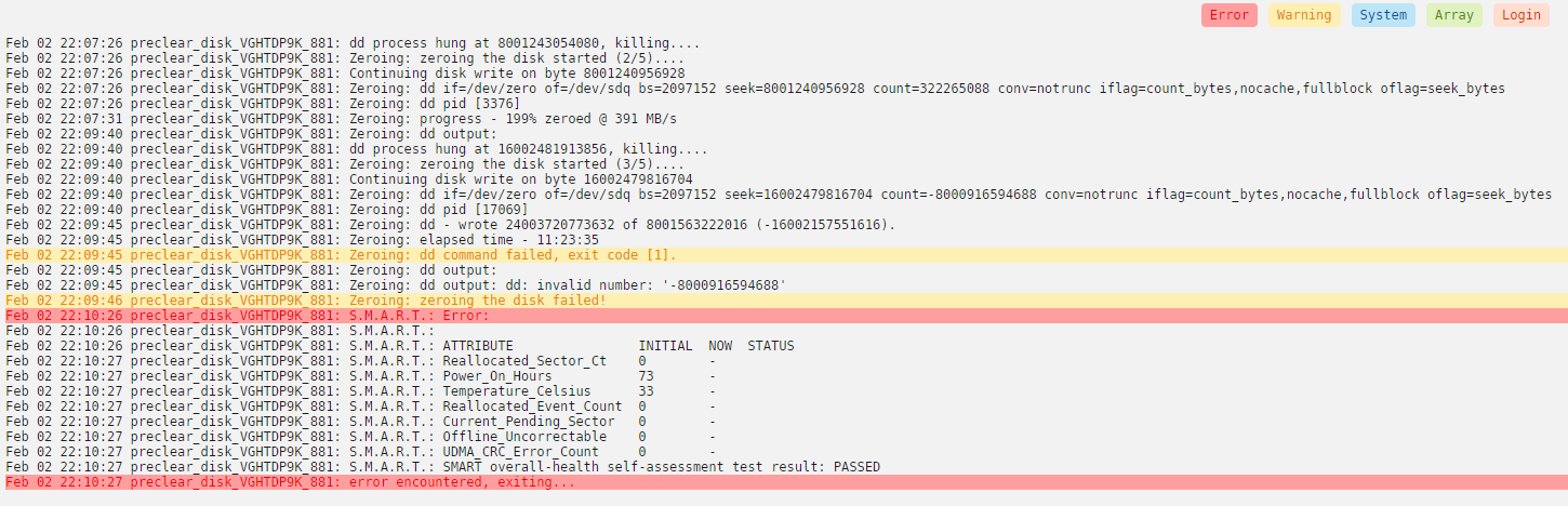

I am getting "Zeroing the disk failed!" error while trying to preclear a brand new 8tb wd red pro-drive. Anyone know what the issue might be? Bad drive? I have only tried this one time. diagnostics attached
This is what the log says:
unraid02-diagnostics-20210202-2345.zip
