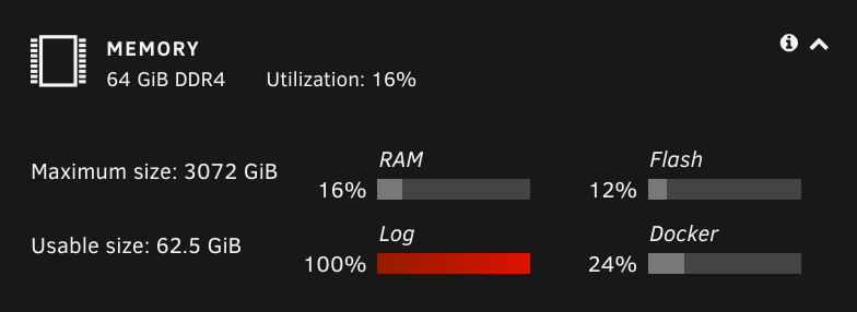

[SOLVED] I waited until the preclears were finished before restarting. Both preclears were successful and after the reboot have been added to the array. As expected after a reboot, my /var/log folder is now only using 1% of available space. Still wish I could figure out why the log was considered full even though I had plenty of available RAM.
Start of Original Message:
I started a zero-only pass of preclear on two new 16TB drives yesterday evening. When I woke this morning I had a message from Fix Common Problems about an error with my setup. That error is a full /var/log folder.  When I checked the unRAID log, it's being flooded with the following:
May 12 04:40:56 AnimNAS preclear_disk_ZL2E3RCH[24492]: tput: unknown terminal "screen"
May 12 04:40:57 AnimNAS preclear_disk_ZL2E3RCH[24492]: tput: unknown terminal "screen"
The last log entry was from 4:40:57 this morning when the system declared the log as 100% full. This doesn't make sense as my understanding is that /var/log resides in RAM when unRAID is loaded. I have 64GB of RAM on the server and it's only showing 16% used, but the dashboard tab also shows the Log at 100% full.
The preclear is 72% complete on both drives and they're still in their USB enclosures until the zero completes successfully. I know a restart will clear the logs but I haven't done one yet as I'm unsure if pausing the zero runs will survive the reboot? Am I safe to reboot after pausing the zero runs? Any idea why my syslog is full of those errors?
TIA for any assistance...
Edited by AgentXXL
Solved the issue.
