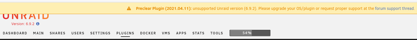

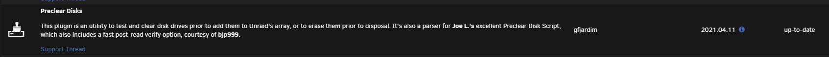

Hi there...Anyone else having this banner pop up? - "Preclear Plugin (2021.04.11): unsupported Unraid version (6.9.2). Please upgrade your OS/plugin or request proper support"
I have checked the plugin and it is up to date:
@gfjardim just wondering if this is a known issue?
Regards
Regards
I'm on 6.9.2 also and same preclear version and I'm not seeing that warning.
Thanks for that....certainly odd behavior and a first for me. I did have a loss of network access and had to reboot after 3 months of happy running. I will monitor and see if it happens again.
Well... first reboot in 2 months, and I now see the incompatibility warning banner!
Funny thing is I've used 6.9.2 and this version of preclear a few times in the last few months and its worked just fine.
I think this might be something driven from CA that @gfjardim needs to make a (hopefully) small update for.

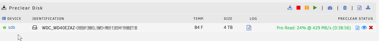

I'm seeing 429MB/s on the pre-read stage of preclear on my WDC blue 4TB hard drive. (info is in the image below)  This drive is a shingle variety.  This isn't read cache, it pretty much has stayed at this speed the whole time.    Is this why the read speeds are so high?  I'll post a follow up on my write speeds.  Is this normal?  I've only seen SSD's have read speeds like this!
1763704856_2021-11-2613_30_15-Tower_PreclearMozillaFirefox.thumb.png.f762a4ce3d7e885a4d811b81db11394e.png
9 hours ago, tr3bjockey said:
Is this normal?
It's normal with WD SMR disks before they were used, reads come from the controller, since it knows the disk is all zeros it doesn't read it, it's also pointless to do a pre-read, post-read will be normal.
