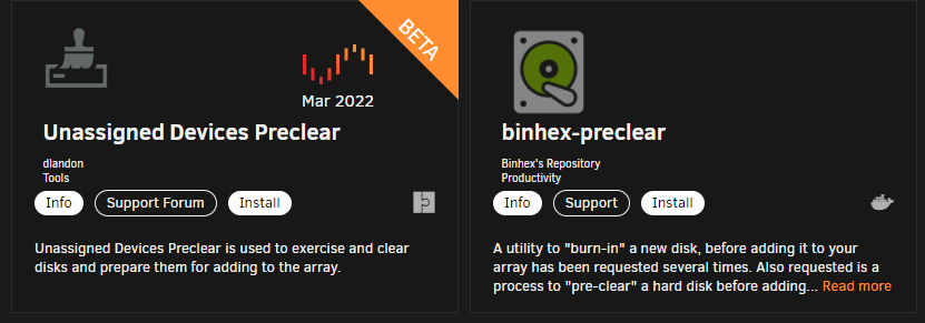

  • Due to various continual issues with this plugin, it has now been marked as being incompatible with Unraid versions 6.9.0+   It is highly advised to uninstall this plugin (and Statistics Sen
  • I think Thanks should be directed at all those members that have been dealing with the mess the last few months. @dlandon and @Squid have been working behind the scenes to try and clean up, and o
  • Dontlookoverthere over on the unRAID subreddit figured out how to get the plugin running again with a simple edit to the plg:   https://www.reddit.com/r/unRAID/comments/7wjpus/preclear_worki

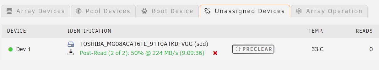

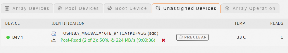

Hi.
I am running a 16TB preclear at the moment (I did the exact same drive two weeks back, no issues).
Preclear has been running fine and I think it still is, but since it started the last POST READ (post read of second phase) the webinterface shows no status anymore, the blinking "preclear" is still there, but no "eye" icon ..
How can I check current status ?
It should be ready somewhere tomorrow so I will just wait, but wondering if there is a logfile underneath somewhere I can look at.. ?
Sure !
Its still running so I am not worried there:
Jan 12 16:39:16 Tower preclear_disk_91T0A1KDFVGG[606]: Post-Read: progress - 50% verified @ 217 MB/s
And this morning preclear was finished without an issue. Report was also placed in the preclear_reports folder.

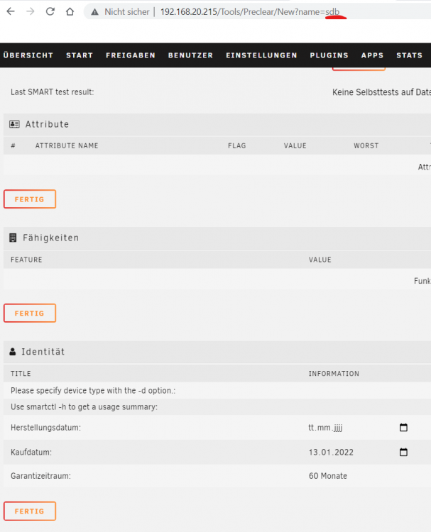

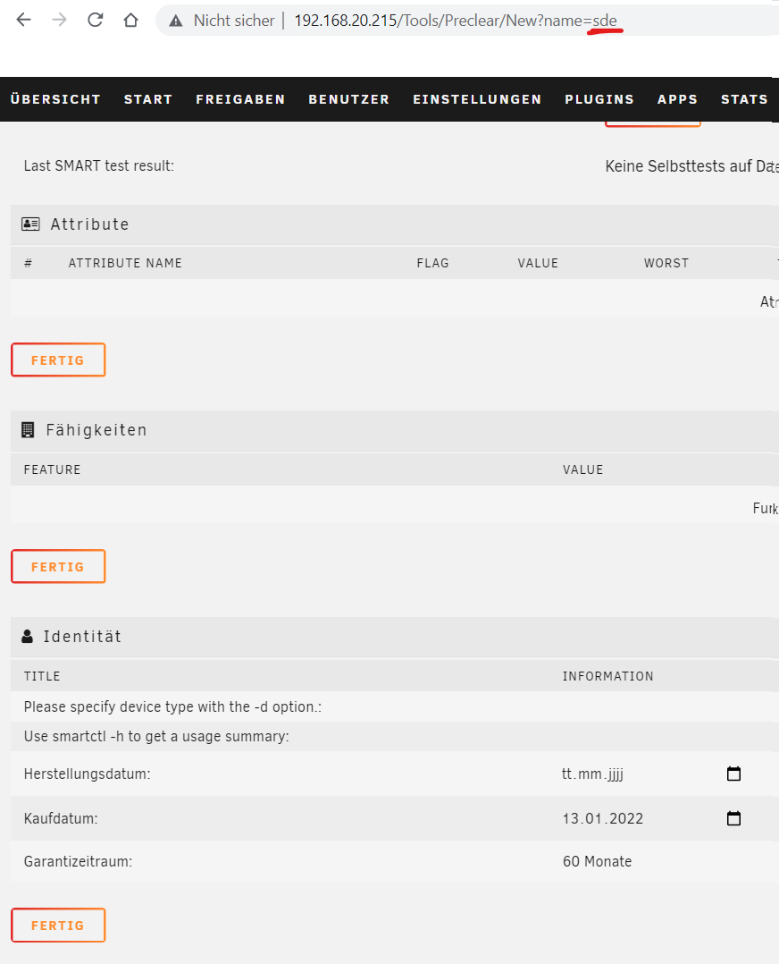

I am the only one who has the same warranty infos for every disk?
What's wrong here?
Edited by enJOyIT
