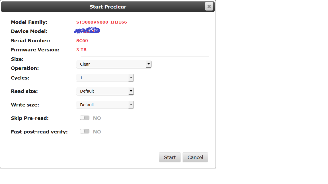

While preclearing a Seagate 3TB NAS drive, I noted that the Start Preclear popup incorrectly displays the drive information (see attachment), where the serial number shows up in the Device Model field, the firmware version in the Serial Number field, and the size in the Firmware Version field. Firefox 44.0.2 is the browser.
I'll investigate this. Thanks for reporting.
