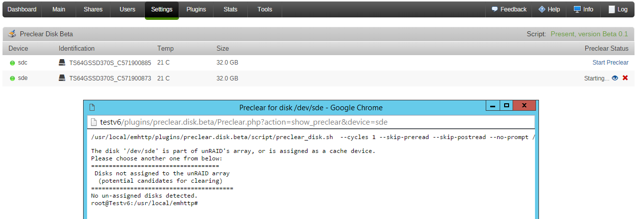

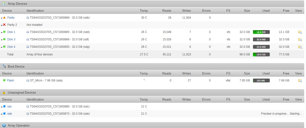

Here it is, guys: https://raw.githubusercontent.com/gfjardim/unRAID-plugins/master/plugins/preclear.disk.beta.plg
It will add a Preclear Disk Beta icon under Settings.
How to test it:
1) Pick a formatted disk or format it with Unassigned Devices and copy some files to it;
2) Go to Settings/PreclearBeta and start a Clear operation;
3) Once it's over, please run a Verify All the Disk operation;
4) If successful, please run both Test and Run the post-read verify operations from the older plugin;
5) If possible, assign the precleared disk to the array and start a Check Parity operation.
All feedbacks are pretty much appreciated.

*For those who notice, don't worry about the temperatures. As it is my test server with test disks I didn't double check the fans. They had failed. Replaced them as of the verify so temperatures are in order.
Links below are screenshots from the Plugins' setup page and from Unassigned Devices on the Main Tab (if you're checking compatibility).

Trying to start a preclear but getting assigned disk error.
Please run the command below and send the the file preclear_beta.txt created on your flash drive:
bash -x /usr/local/emhttp/plugins/preclear.disk.beta/script/preclear_disk.sh /dev/sde >/boot/preclear_beta.txt
