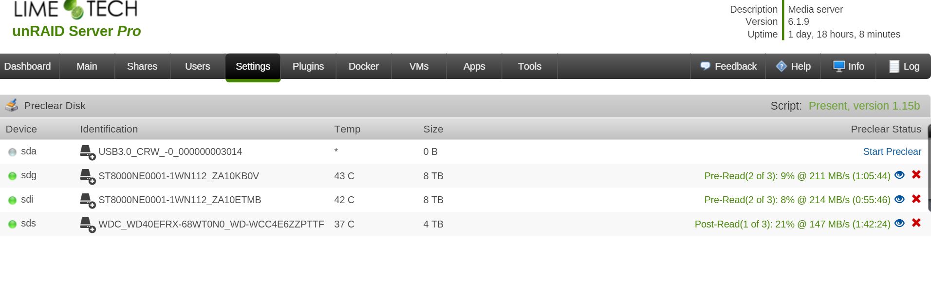

I have been Preclearing 3 HHD withe the PreClear Beta for 2 days now.
It is in the PreRead phase of cycle 2 for 2 8tb hard drives and iI think n the PreRead phase for a 4tb drive running.
When I attempted to open the plugin to watch the progress I received
this error and the plugin refuses to open though the preclear appears to continue to run
Any idea what I should do ?

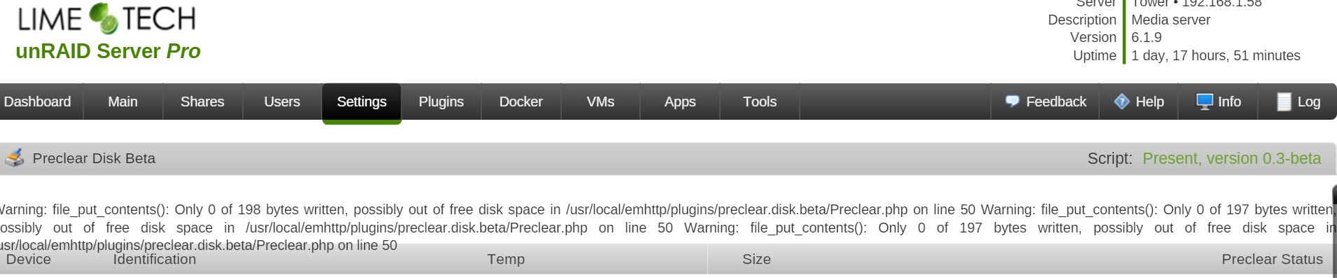

Your /var/log directory is full. If you have enough RAM, you should run this command:
mount -o remount,size=256m /var/log
Add that to your /boot/config/go file to make it persistent.

if I open the older Preclear plugin (Non Beta version )
it displays correctly

That's expected since the Beta version has a lot more logging, not just errors.

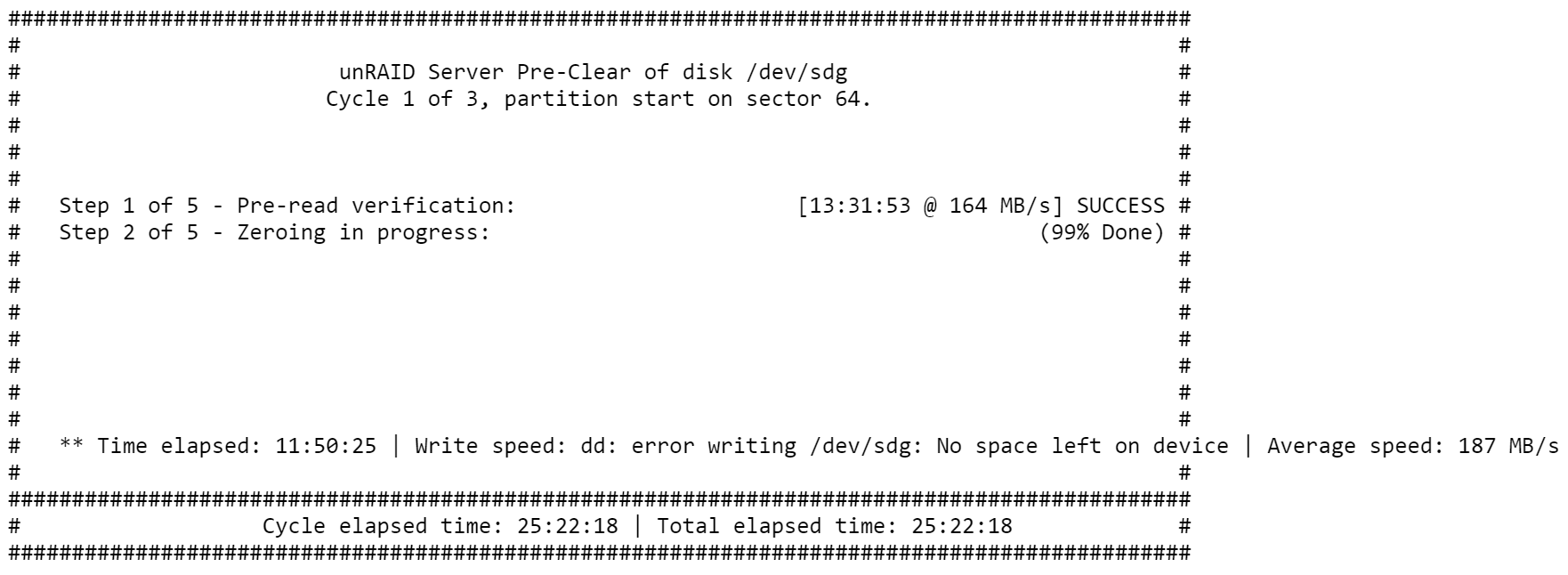

Also you may want to know about this end of file error that gets displayed when the script gets to the end of the disk.

As the PreClear Beta continues on my 3 HHDs. 2- 8tb and 1- 4tb I received the following error message again when I checked the status.
The HDDs are currently in Cycle 2, Step 2, Zeroing.
Several days of preclearing so I hate to interrupt or cancel at this point
Warning: file_put_contents(): Only 0 of 197 bytes written, possibly out of free disk space in /usr/local/emhttp/plugins/preclear.disk.beta/Preclear.php on line 50 Warning: file_put_contents(): Only 0 of 196 bytes written, possibly out of free disk space in /usr/local/emhttp/plugins/preclear.disk.beta/Preclear.php on line 50 Warning: file_put_contents(): Only 0 of 196 bytes written, possibly out of free disk space in /usr/local/emhttp/plugins/preclear.disk.beta/Preclear.php on line 50

I have already entered the code you suggested previously including adding it to the go file.

Do I still need the added line .... mount -o remount,size=256m /var/log......in the Go file ?

If you have spare RAM memory, then better you leave it there. Lots of plugins use that directory for logging.
