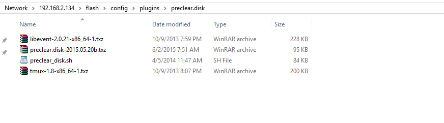

I tried using your recommendation and the 2 files I downloaded and received were only 1kb in size.
I don't understand why I am having a problem downloading only those  2 files or why the plugin does not install correctly.
I was hoping the OP could enlighten me on the problem.
I went directly to the Slackware site and downloaded the 3 correct txz files.
Can you or someone advise me what directory or folder names to use and where to place the files after unpacking them.
Currently I have them in separate folders.
libevent
tmux
usr
All in the preclear.disk folder which also includes the file for preclear_disk.sh
The plugin will go to Starting but does not run.
And eventually I stop it within the plugin
my plugin setup that is working just fine for reference
Morbidpete
Thank you for the setup info.
I got it working.
Your setup info resolved what to do with the 3 txz files needed.
I was never able to resolve why when I ran the plugin 2 of the 3 txz files were empty. But I was able to get the correct files by going directly to the Slackware site and add them after installing the plugin.
The final thing I found and this is really stupid on my part.
I am using Adblockplus and it stopped me from receiving the preclear messages from within the Chrome browser.
Turning it off for the Tower pages solved the last problem.
Thanks again for all who stepped in to help.

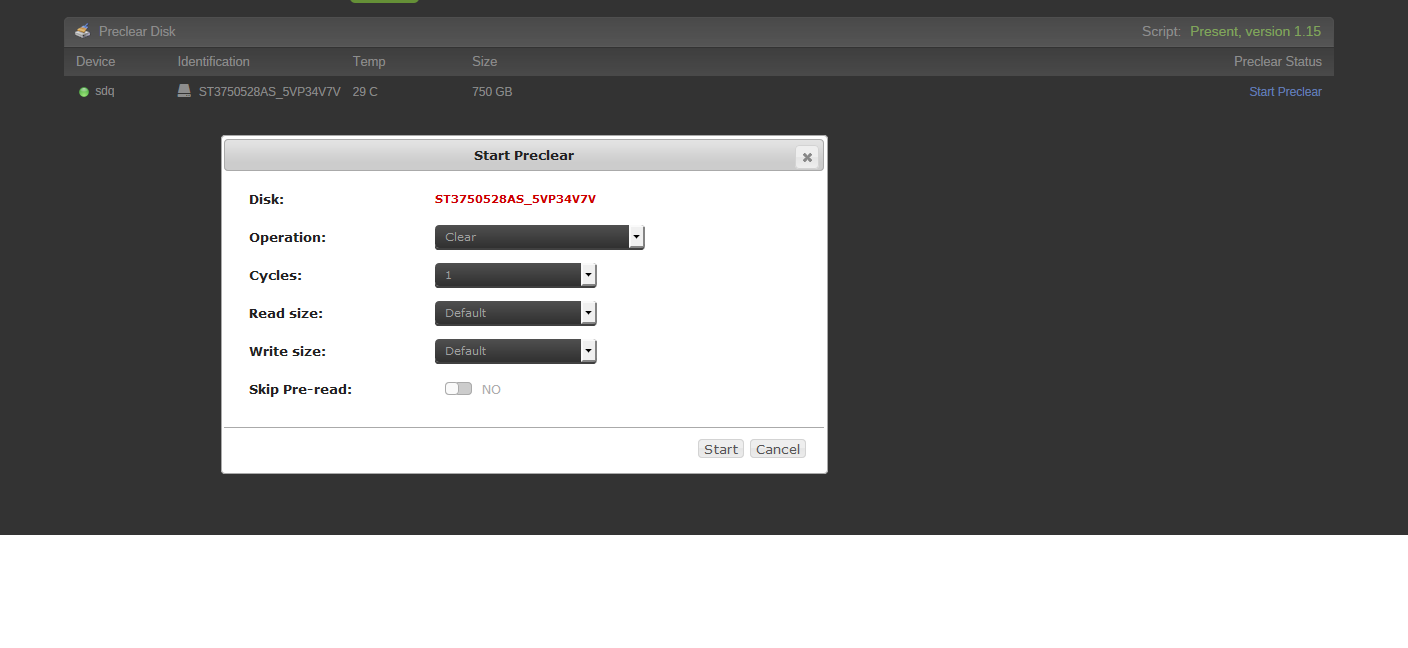

Love the Plugin.... Easy as can be... using it for first time to pre-clear a 4TB drive.
I do have one enhancement suggestion:
There is the drop-down list that lest you choose the different actions to perform (clear, test, ?, etc.). It would be very helpful to have a description that clearly states what each of these options do. When, why, and how you would use each of the options listed.
This is more of a reference than a functional feature. It would really help the non-power-experts.
Thanks for this!!
I very much agree! Maybe tie it into the "help" button?
Installed a new 3TB WD Red drive today and when i click "start preclear" nothing happens.
Did you add the preclear_disk.sh script to the config/plugins/preclear.disk folder ?
If you have a popup or any Ad Blockers you have to turn them off for this page
Sometimes I have to multiple click the Start Preclear button
Your preclear.disk folder should be like the one above in reply #60 from morbidpete
And make sure the file sizes match the ones in reply #60 as I could not download them via the plug in an had to manually download them.

I also have problems clicking on start preclear or the eye to get the status. Sometimes it's not working at all no matter how many times I click. This is on Chrome Version 43.0.2357.124 m and Internet Exploder 11. After trying in Firefox every browser seems to work again.
After the preclear has started and I try to click the eye, it's back to the same problem. Using Firefox makes the other browsers work again also, but I might have to click it twice sometimes to get it to pop up.
