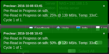

I've got a preclear running on a new drive, and all is going wonderfully, except...
I've been having issues getting email notifications since I changed my gmail password (separate issue raised for that), so I  set up a Pushover account. I am getting test messages sent via Pushover from the Notification Settings menu in unRAID.
When I launched the preclear, I turned on all notifications - email, GUI & Notifications.
I'm not getting email - as I expected
I am getting GUI pop ups (see attachment)
I'm not getting Pushover - I'm surprised.
Is there any logging I can look at for the preclear to see if it's returning an error to see what the issue is? I do know that I can get a test message via unRAID. I don't remember if I've yet received a regular status update via Pushover, so I don't know if unRAID is working in general beyond just the test messages.

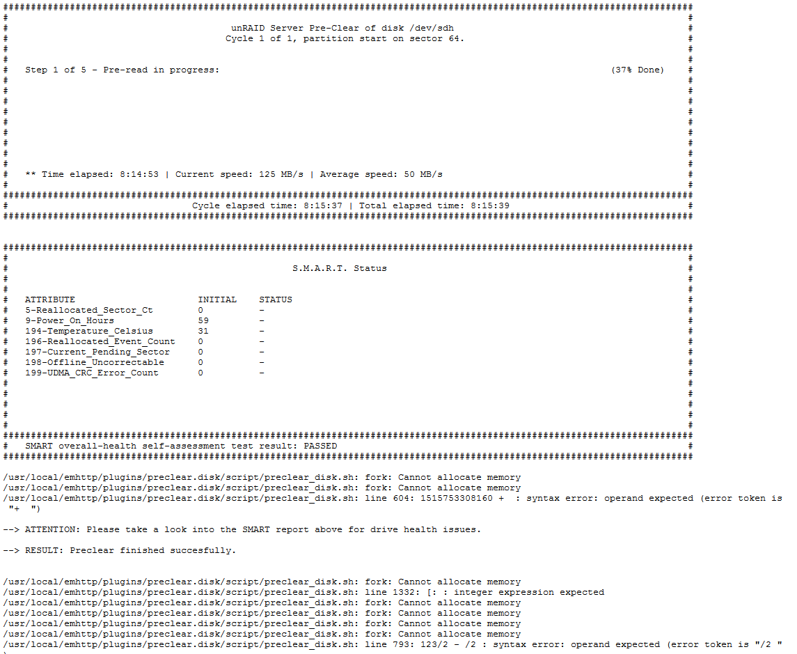

I started a preclear, but it seems to be hung. When I click the little blue eyeball for the preview, I see:
/usr/local/emhttp/plugins/preclear.disk/script/preclear_disk.sh: fork: cannot allocate memory
My pre-clear hasn't progressed beyond 53% overnight.
Clicking the X to cancel the preclear doesn't seem to be working, either.
Troubleshooting tips appreciated.
As a follow up, it's been sitting at 53% @ 39MB/s (15:08:06) at least since I posted the last message.
Do I need to restart the server to kill it & try again?

2) Killed session of preclear: if the X icon isn't working, you can kill it by typing the following code: tmux kill-session -t preclear_disk_sdX
I did that, but it's still showing results, and the X says it will clear stats, but doesn't. I guess I could restart it by hand, but... ewww!  ;)
Any other tips?

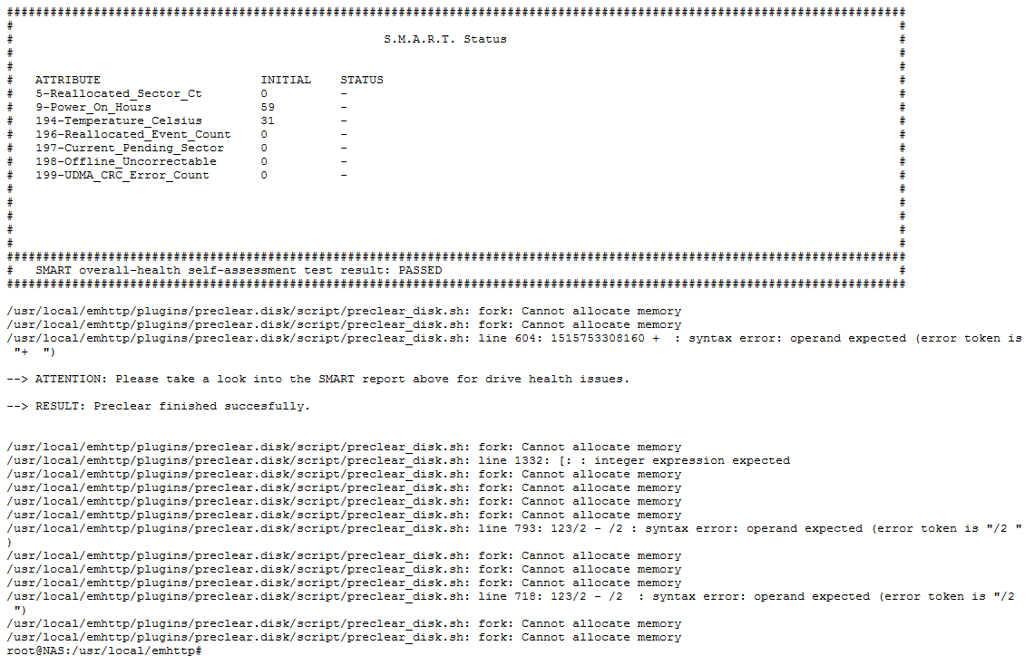

I rebooted the server, and it let me restart the preclear. Now it's telling me that the preclear is done. gfjardim, you've done some amazing work, brother! That's a 4TB drive cleared in... 12 hours!!
OK, probably not. :(
 preclear_disk.sh -t /dev/sdh
Yields all the instructions on how to call preclear_disk.sh followed by:
Sorry: Device /dev/sdh is busy.: 1
All that's in /boot/preclear_reports is a report for the drive that died last week. It's dated Sept 17th, and is full of:
tput: unknown terminal "screen"
(6536 bytes worth).
I redownloaded the original preclear_disk.zip, extracted preclear_disk.sh from it and compared SHA256 fingerprints from the fresh copy v the copy I'm actually using, and they match.
I know gfjardim is busy, so I probably won't get a response from him for a couple of days (I get it - real life. Glad he's got one!). Anyone else have any suggestions?
No, the drive's not hot swappable, unfortunately. (I guess I need to watch Office Space again, 'cause I totally didn't get the reference...)
I'm attaching screenshots of the "preview" (clicking the blue eye), since it won't let me copy/pasta the text.
The original preclear_disk.sh has to be patched in order to work with unRAID 6.2
Remove the plugin and reinstall it again.
