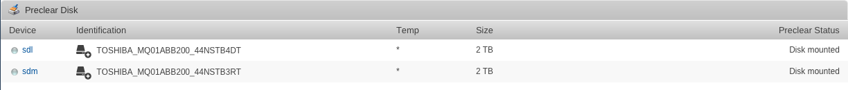

First thank you for the script/plugin, been using them for a while now since unRAID 6.0, and using Joe L.'s pre-clear script long before.  You've made the process such a breeze now.
Quick question, and I'm sure it's been asked before, but I just don't have the time to go through the thread. (Perhaps edit(ing) the first post with updates, and a FAQ?, something I think needs to be done a lot more on these forums, or move to a better forum software...  but I digress)
My issue is I'm not getting any S.M.A.R.T. reporting in neither the status view while pre-clear is running, or at the end in my reports.  The box is just blank.  I'm sure it's a quick fix, and other than that everything is working well.
Thanks again!
S.M.A.R.T. status becomes unavailable if the script can't detect your controller properly. Do you mind sharing your server configuration and which controller is hosting your disk?
I think this has been mentioned a couple of times before in this thread, that some new drives doesn't have SMART enabled by default and therefor need it enabled before starting the script. After adding the drive to the array, SMART is available.
I have had this on a few new drives when using your plugin and script. It might have been johnnie.black that mentioned this.
I question that this is my issue, because I can run full SMART status requests from the unRAID web GUI, and I get full SMART status reporting through the unRAID
GUI as well.
I did try adding the drive(s) to the array and back, but same result.
Feel like I was left at the buss stop.
Any advice?

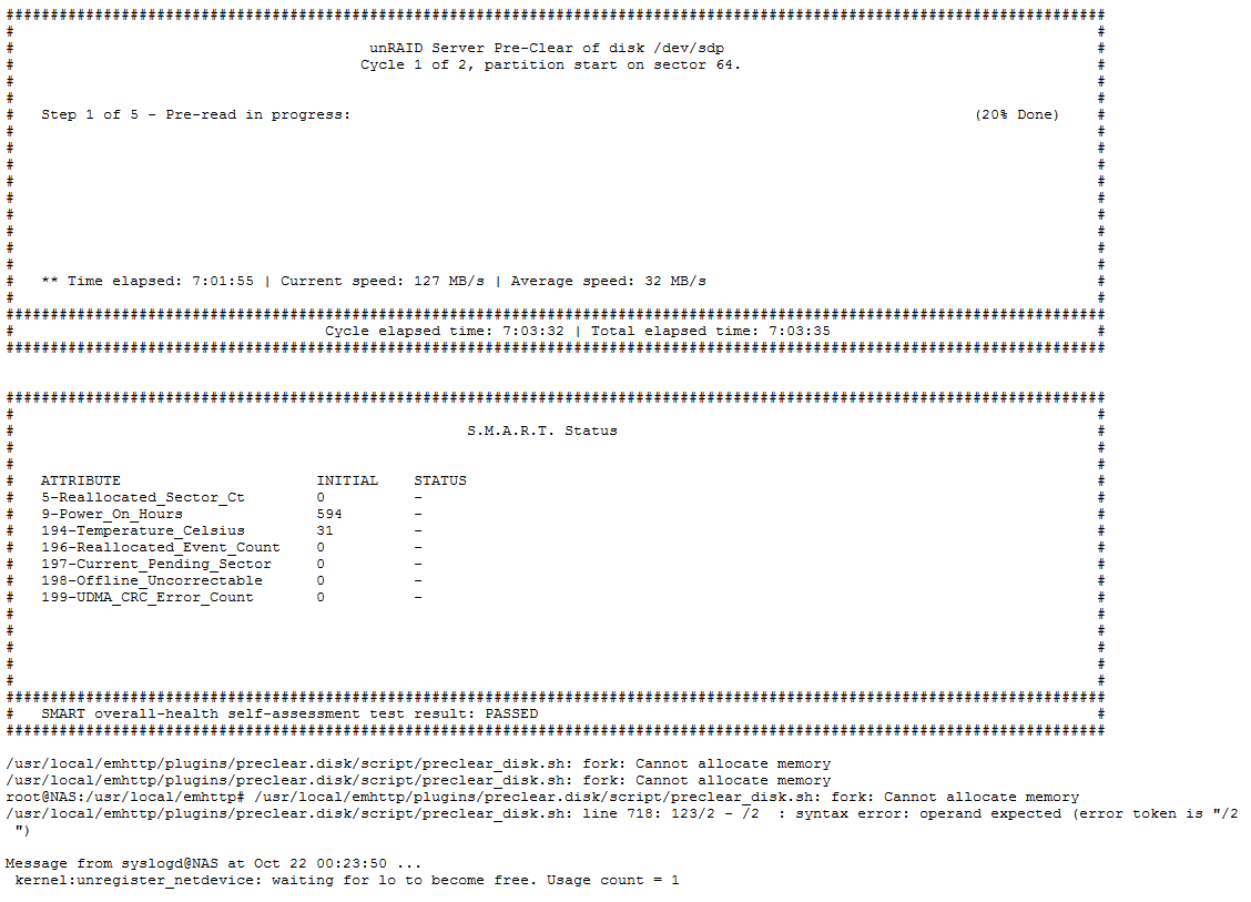

Finally got through a massive issue with emhttp hanging and the server not shutting down. I've removed & reinstalled the plug in.
Going to let the preclear run with nothing else (dockers) running on the server. Hoping I get through it this time.

The original preclear_disk.sh has to be patched in order to work with unRAID 6.2
Is this the case?  I am on 6.2 and the pre-clear hanges on the read process and will not allow me to cancel.  Have to reboot the server.
I redownloaded the original preclear_disk.zip, extracted preclear_disk.sh from it and compared SHA256 fingerprints from the fresh copy v the copy I'm actually using, and they match.

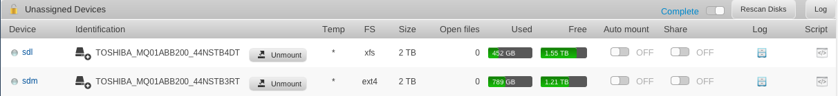

I was just wondering if the preclear signature gets deleted when formatting a precleared drive using the Unassigned Devices plugin afterwards?
So is it safe to preclear a drive, format it with UD and just assign it to the array when needed some day?
Or should I just leave it precleared and let unRAID format the drive when adding it to the array?
Signature will be deleted.
Yes, formatting a disk removes the 'clear' signature.
Not a good idea unless you actually want to use it via UD in the meantime for storing data.    If you have formatted the drive in UD, then when you later try to add it to the parity protected array, unRAID will go through its clear process wiping existing contents and then on completing the clear expect you to format it from within unRAID.
this would be the recommended approach in most cases.    The format from from within unRAID only takes moments, it is the long 'clear' step that is avoided by having it pre-cleared.
Alright, thanks for clarifying

I have a problem with one server in that it is running out of log space. My investigation reveals a rapidly growing /var/log/preclear.disk.log file. My other servers don't have this file at all, but they don't have any unassigned devices either. Whenever the Main window of the GUI is open, or when I go to Tools -> Preclear Disks I get four entries added to the aforementioned log file every ten seconds:
Thu Oct 20 20:50:12 BST 2016: PHP Warning: syntax error, unexpected $end, expecting TC_DOLLAR_CURLY or TC_QUOTED_STRING or '"' in /var/state/preclear.disk/state.ini on line 8
in /usr/local/emhttp/plugins/preclear.disk/Preclear.php on line 273
Thu Oct 20 20:50:12 BST 2016: PHP Warning: array_key_exists() expects parameter 2 to be array, boolean given in /usr/local/emhttp/plugins/preclear.disk/Preclear.php on line 275
If I navigate away to some other page, such as the Dashboard, the log file stops growing until I switch back to either the Main page or the Preclear Disk page.
I have two (unassigned) disks in the affected server, both mounted using the Unassigned Devices plugin.
The problem seems to be associated with the file called /var/state/preclear.disk/state.ini mentioned in the error messages. This file also only exists on the affected server and is absent from my others.

This is obviously a reference to my /dev/sdl (see attached screenshots). Does anyone know what the problem is and how to fix it? Should there be a newline at the end of the state.ini file?
EDIT: unRAID version 6.2.1, plugin version 2016.09.27 (both latest stable)

Preclear just doesn't seem to like me much lately...
I've launched a preclear on a drive that, admittedly, I've had other trouble with.
This time, I've started the preclear with the drive attached to a USB3.0 -> SATA adapter, and the drive is outside the case. I started the preclear on 10/21 at 06:41 local, and it seems to have hung after 7 hours of processing at 20% complete (first attachment). I kept seeing that it was running at 32MB/s and thought that was insanely slow, but didn't register that it was also only reporting 7 hours of processing time when it's been nearly 36 hours since I launched the preclear, therefore, I've just left it running while doing other stuff.
The log reports that it couldn't allocate memory and, therefore, there was a script error (second attachment). I've got 8GB of RAM in the box, but I do have a bunch of dockers running (see .sig).
A) It would be nice if the script could be made a bit more robust to capture these errors and not just hang. Easier said than done, I understand.
B) Is is possible to copy text from the log window? Firefox just doesn't seem to want to let me do that, hence the screen cap instead.
C) What do I need to do now? I presume that I need to just stop the preclear (though I had issues with that previously and ended up having to power off the machine with a long-press of the power button, and would like to avoid that again if possible).
Do I simply not have enough RAM to support the configuration I'm attempting to run?
I readily acknowledge that there could simply be issues with the drive, having had a bit of a smoke (see first link), but it does seem to have passed SMART testing. I'd like to make a rather thorough test of the drive before giving up on it, since it's passed HGST's tests, they won't RMA it, even through it's still under warranty.
