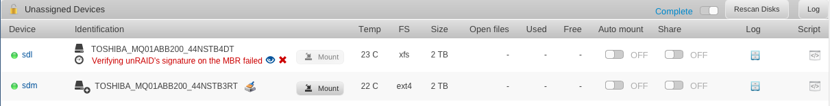

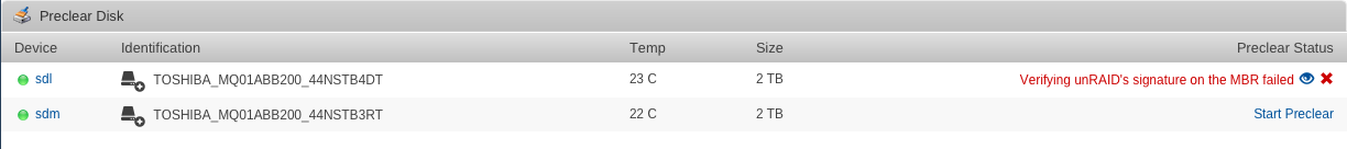

Testing the 2016.10.26 version, I tried the gfjardim script to "Verify MBR only" a disk that has an XFS filesystem on it. As expected it failed the unRAID signature test. But how do I clear the red failed report? Clicking the red cross does nothing.
The view from Unassigned Devices looks like this. As I can't clear the red message the Mount button is greyed out. The eye icon works but the red cross doesn't.
EDIT: It seems to be a browser (Safari) issue. I cleared the cache and history but it still didn't work. I tried Chrome and it works.
