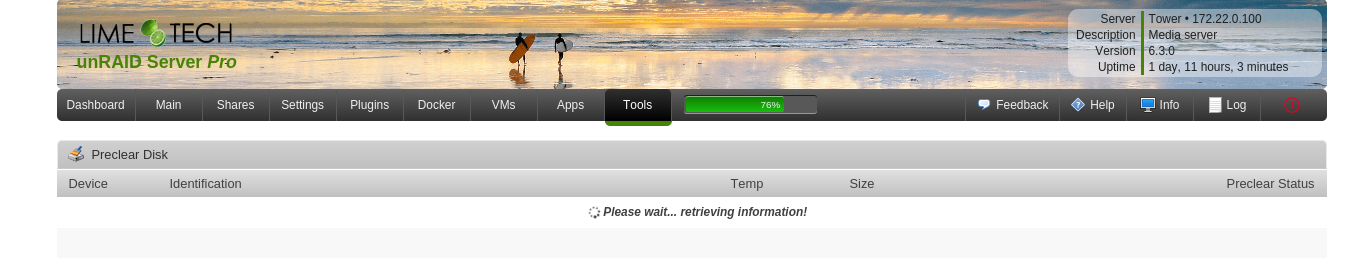

Hi there
Im trying to run preclear on unRAID 6.3.1 but when I open preclear from tools it seems to be stuck on
Please wait... retrieving information!
I've also tried running the script in a terminal from /boot/config/plugins/preclear.disk/preclear.sh and it fails saying
sfdisk: invalid option -- 'R'
For more details see sfdisk(.
Sorry: Device /dev/sdp is busy.: 1
I've also tried clicking the icon on the main page under the unassigned device section, and the button doesn't do anything.
I've also tried using a different browser (Chrome instead of Safari)
Any ideas, as I'm very keen to start a preclear on a new disk, especially as its 6TB and I'm expecting it will take much longer than I'm used to. Thanks in advance for any help!!

Hi.
First step is to remove and install this plugin again, to make sure it's in the latest version. The next step is choose which script you want to use to preclear; if you use mine, all you have to do is start the preclear. If you want to Joe L. script, you have to follow the steps on the OP, and then patch the script like described here: http://lime-technology.com/forum/index.php?topic=13054.msg510567#msg510567
