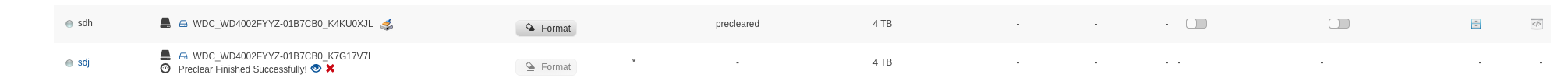

On 2018-01-22 at 1:04 PM, Limy said:
I'm currently running the stable release 6.4.0 and I have only one problem with the Preclear plugin.
After I preclear the drive in the unassigned devices section, It says that the preclear completed successfully, but I have the option to cancel currently running preclear as can be seen in the attached screenshot.
5a66429b18ec5_ScreenShot2018-01-22at12_35_04PM.thumb.png.b10251b2d966a454bb23c2e6e694aff0.png
I cannot get that message to disappear unless I stop the unRAID server and reboot the server, which then gives me this attached screenshot.
5a66429c063f9_ScreenShot2018-01-22at12_39_18PM.thumb.png.a47d4197a27cd055183ef67112a2b509.png
Is this normal behaviour with this plugin?

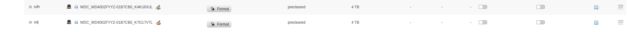

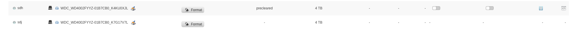

Here is a followup of my testing to try to get to the bottom of this.
So I re-ran the Preclear (1 Cycle).  After the preclear, the unassigned shows this:
5a679668150fd_ScreenShot2018-01-23at12_55_24PM.thumb.png.305751045842305d21b3b7d03b961866.png
Clearly it shows the it's completed and the e-mail notification indicate that as well.
So I pressed the Red X and I was presented with the following screen:
5a679668eb770_ScreenShot2018-01-23at12_55_42PM.thumb.png.8e07e7afaaaf5ece1f4717d7c0a5510a.png
As you can see, the drive does not show the status as precleared.  It does not change even if you refresh the screen.
So I shutdown two VM's that I was running and then went back to the Main tab and now the screen shows this:
5a6796670377d_ScreenShot2018-01-23at1_03_51PM.thumb.png.411ecb743793485d48807358c46b6478.png
All I can say, is that I really am baffled by this.  I would be happy to hear from anyone else that has noticed this behaviour.
I’m not sure there is such a status. What you are seeing is that the drive can either be precleared again or formatted. Not sure what behavior you’re expecting. Maybe I’m missing something?
Sorry wgstarks, I should have been more clear.  What my issue is I guess is that the FS column in the Unassigned Devices did not show the drive as precleared until I stopped the VM's that I was running.
Personally I think that after you preclear a drive, it should update the information in the Unassigned Devices section when it is completed.  Currently on my install that is not occurring.
I guess I expected a different behaviour.
Thanks for responding.
VMs have nothing to do with this status.  It's probably because you left the UD web page and then came back.  You can probably accomplish the same thing by refreshing the page, or clicking the Rescan icon in the upper right corner of the UD web page.
Thanks dlandon for that tip.  I totally forgot about the Rescan Disks icon.  Thanks for pointing that out.

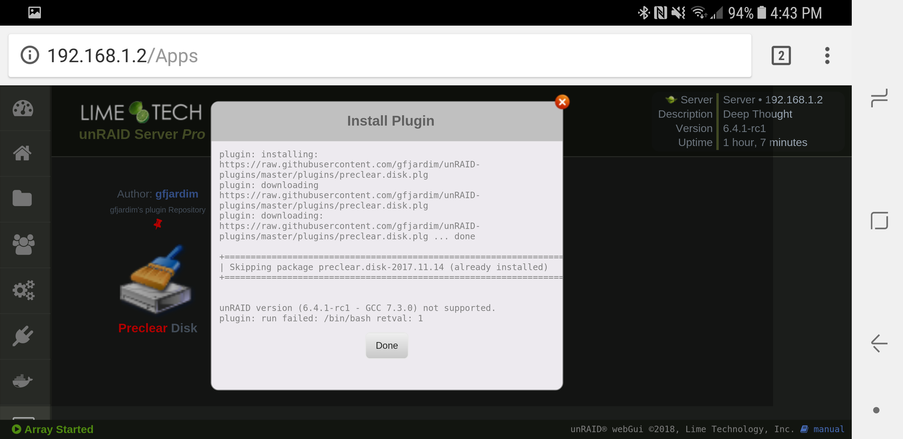

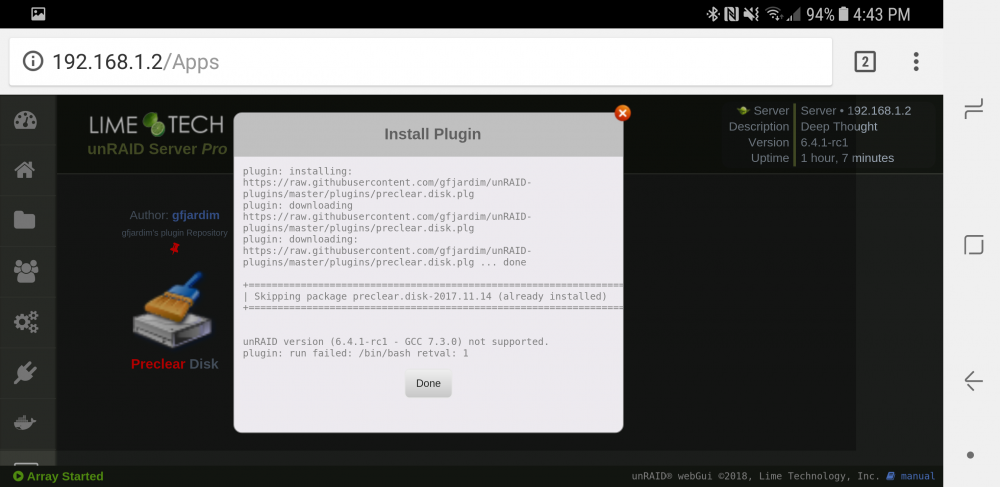

Don't suppose we could get some 6.4.1 RCx support could we? Getting incompatible errors.
You might get a quicker response with a more detailed description of what the incompatible errors are and a diagnostics file.
8 minutes ago, AnnabellaRenee87 said:
Didn't mean to come off as rude, feeling under the weather today. It's installed, I assume once it's updated it will start working again.
Sorry ?
The reason that I asked about what you are seeing is that it was installed on my Test Bed server and I am currently running 6.4.1-rc1 and the plugin initializes when the icon is clicked in the Tool tab.  (I don't have a disk available for testing the actual preclearing at the present time.)
You've probably got the errors in your syslog since Preclear was installed prior to your upgrade.  This problem will require an update to the plugin by @gfjardim

When I try to install PreClear on unRAID 6.4.1 I get this error
unRAID version (6.4.1 - GCC 7.3.0) not supported.
The plugin needs to be updated for compatibility with unRAID 6.4.x (see some of the other posts on this page).
