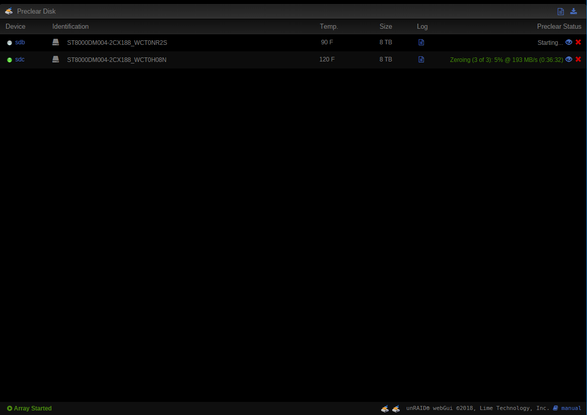

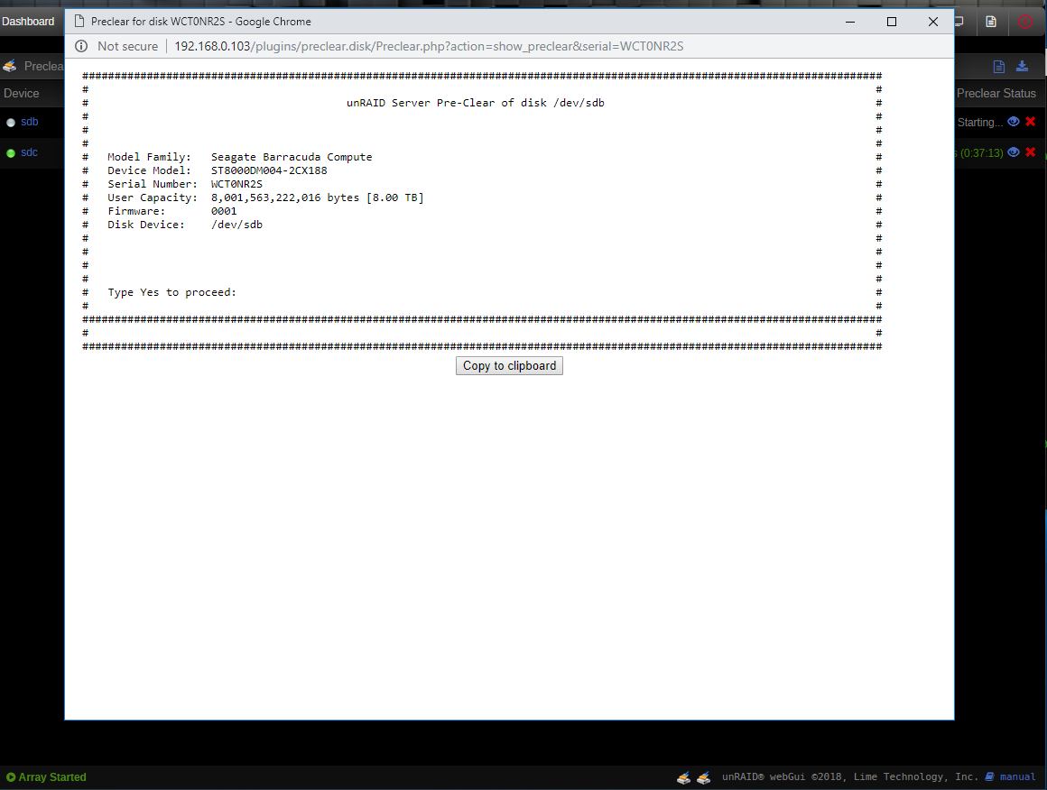

I'm experiencing a slight problem with gfjardim's preclear plugin. I was right in the middle of a 3 cycle run of preclears on 2x 8TB drives when my server locked up and the webUI and the local GUI were completely frozen.  I was forced to hard reset the server.  After coming on line and restarting my array, I was able to resume both preclear runs.  One of them began running right from where it left off.  The second drive seems to be stuck at "starting", but nothing is happening.  That was over 12 hours ago.  I left it overnight and while I was at work just in case. The preclear log for that run seems to be stuck at " Type Yes to proceed:"
I'm running unRaid 6.5.2
Preclear Ver 2018.09.20
I know there are updates to both, I was right in the middle of clearing these drives, so I didn't want to change anything and have to start the process over.
Any thoughts on what I can do to get this preclear to resume from where it left off, or do I need to start over? Can I update the preclear plugin while running a preclear on a drive? My first reaction was that I better not.
Thanks for any help.

Please send me the plugin log (see the first post of this topic).
I guess I missed the part about it being a different log.  My wife set down my dinner right as I was typing this up, so steak and potatoes made me read a bit faster than usual. I knew I was going to miss something, I so rarely have issues, that when one comes around I lose basic sense and become "that guy who can't rtfm". I've attached the log you requested.

I think your server locked while the script was writing the resume information on the boot flash drive. You must cancel the resume popup and start a new instance of preclear to that drive.
Oh, ok.  Ouch, these 8TB take a while, but I guess that's the cost of doing business with large drives.  Thanks for the help, it is greatly appreciated.  Now I have to figure out why the thing crashed in the first place.  On to the next mission....
Yep. I changed the logic on the script too, so it can write the whole resume information to the flash drive and then rename it.
