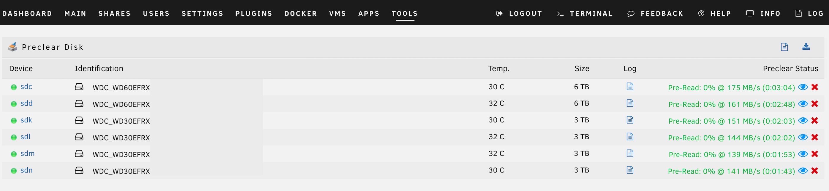

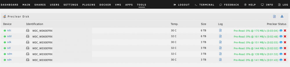

I'm preclearing an 8tb drive
Its zeroing at between 10 and 12  mb/s is that normal?
If I'm right with my rough calculations, that means it would take about 9 days or so to preclear the drive. Probably shouldn't take that long. Try restarting the system after cancelling the preclear and see what the speed is at that point.

4 minutes ago, jonF said:
diagnostics attached
Your plugins are way out-of-date, including the preclear plugin.
Thanks! the update did it . 189 MB/s
Thank you!

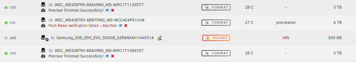

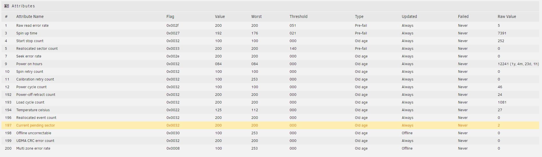

Hi all!
Running unRAID v6.6.6 and Preclear Disks plugin v2018.10.07
Have two sets of questions:

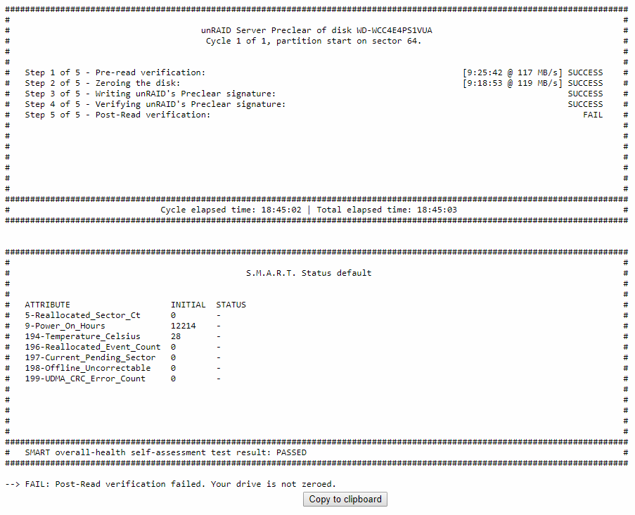

1) I ran preclear on 3 of my drives, with two 3TB drives completing successfully and one 4TB drive failing the post-read. I also got a notification that the raw value for the current pending sector count on the 4TB drive was now 2 (fairly certain it was 0 before preclear).
Some cursory googling brought up the possibility of a memory issue. However, since the 2x 3TBs were precleared successfully, am I right in thinking memory probably isn't the issue?
I do have two more 4TB drives that I'm also planning to preclear. EDIT: I subsequently ran preclear on the remaining 2x 4TB drives. Both completed successfully.
Should I try preclearing the failed drive again or should I just plan on swapping it?
Here is the failed drive's preclear results:

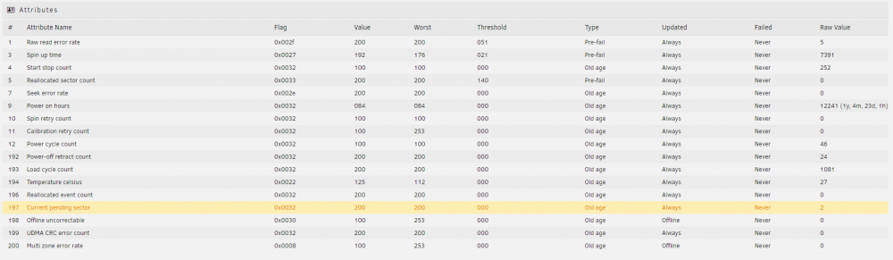

Here are the current SMART data from the same drive:

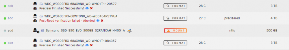

2) Also, I noticed that even though the preclear completed successfully on the 2x 3TB drives, the "Stop Preclear" button is still there.
Do I still need to click that red 'x' even after a successful preclear? Or can I just start assigning it to the array?
And why is the failed drive denoted as "precleared" even though it failed and the two precleared drives aren't denoted as such?
Thanks for any and all help!
Edited by rragu
update on subsequent preclear results
I noticed this as well. It showed precleared successful, but I had to X to close it. Unfortunately, it seems like the final step of tagging the drive as precleared is not occurring either, so Unraid is now spending 12 hours clearing it...
I asked the same question on the unRAID subreddit and got the following explanation:
I think the preclear jobs actually run in tmux sessions, I imagine the red X just ends that tmux session. No harm in exiting them with the red X.
So, I waited until the preclear plugin notified me that all the preclearing was completed for my second set of drives. Then I restarted the array. The "Stop Preclear" button was gone and the relevant drives were properly denoted as precleared.
Since no one has taken the time to reply about the state of this drive, let me give you my thoughts.
I would never add a drive to a array which had any Attributes numbered 187, 188, 197 or  198 that were not zero.  I would not add a drive to an array whose  Attribute number 5 was not zero UNLESS that drive had been through THREE  preclear cycles with increasing!
Attribute number 199 is the one  Unraid 'flagged' attribute which is usually not related to a potential drive failure.  It is usually a cabling or (rarely) controller issue.
In your case, another complete preclear cycle should clear up the two #197 errors but that should also result in a corresponding increase in the Reallocated Sector Count (#5).  (I, personally, would then run another two preclear cycles to make sure that everything was now staple!)
The reason for my caution is that replacement of a failed array drive always has the potential to cause data loss.  Rebuilding a failed drive requires (in a single parity setup) that every sector on every other drive in the array must be able to read perfectly.  If only one sector on any drive cannot be read during the rebuild then the rebuild will fail.  For this reason, I never want to deliberately put any drive into any array that I  have the least question about its initial reliability! I would RMA this drive if possible.  (My past experience is that HD manufacturers  don't argue about warranty claims.  They have always shipped the replacement to me on the day they receive the old one! After all, ripping out a drive out of most computers for warranty replacement is really big hassle and every few people do it on a whim!)
