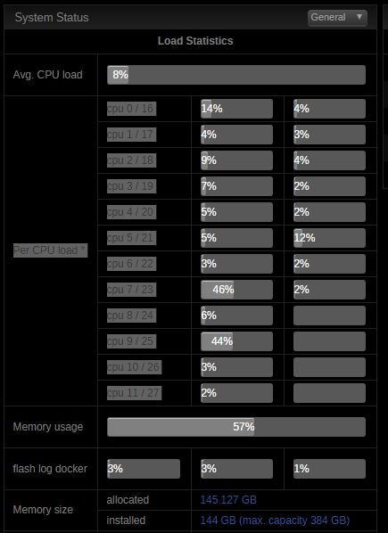

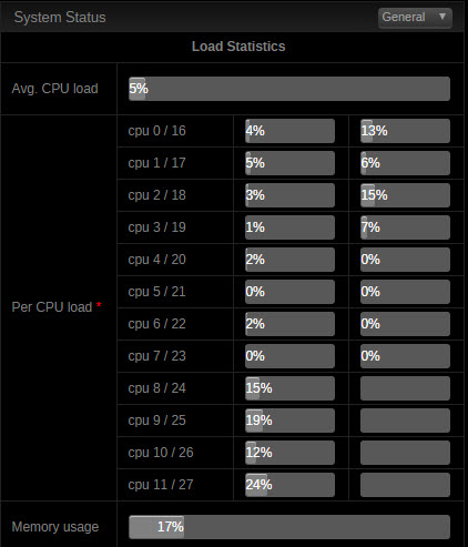

I am also having a similar numbering issue.
My CPU's were numbered from 0-23 previously but now skip 12-15
cpu 0 / 16
cpu 1 / 17
cpu 2 / 18
cpu 3 / 19
cpu 4 / 20
cpu 5 / 21
cpu 6 / 22
cpu 7 / 23
cpu 8 / 24
cpu 9 / 25
cpu 10 / 26
cpu 11 / 27
The System Status does not show CPU % for CPUs 24-27
I get the same Invalid Value error when trying to use CPUs 12-15
I can manually edit the XML to change to use CPU's 24-27 and the VMs will run without error.

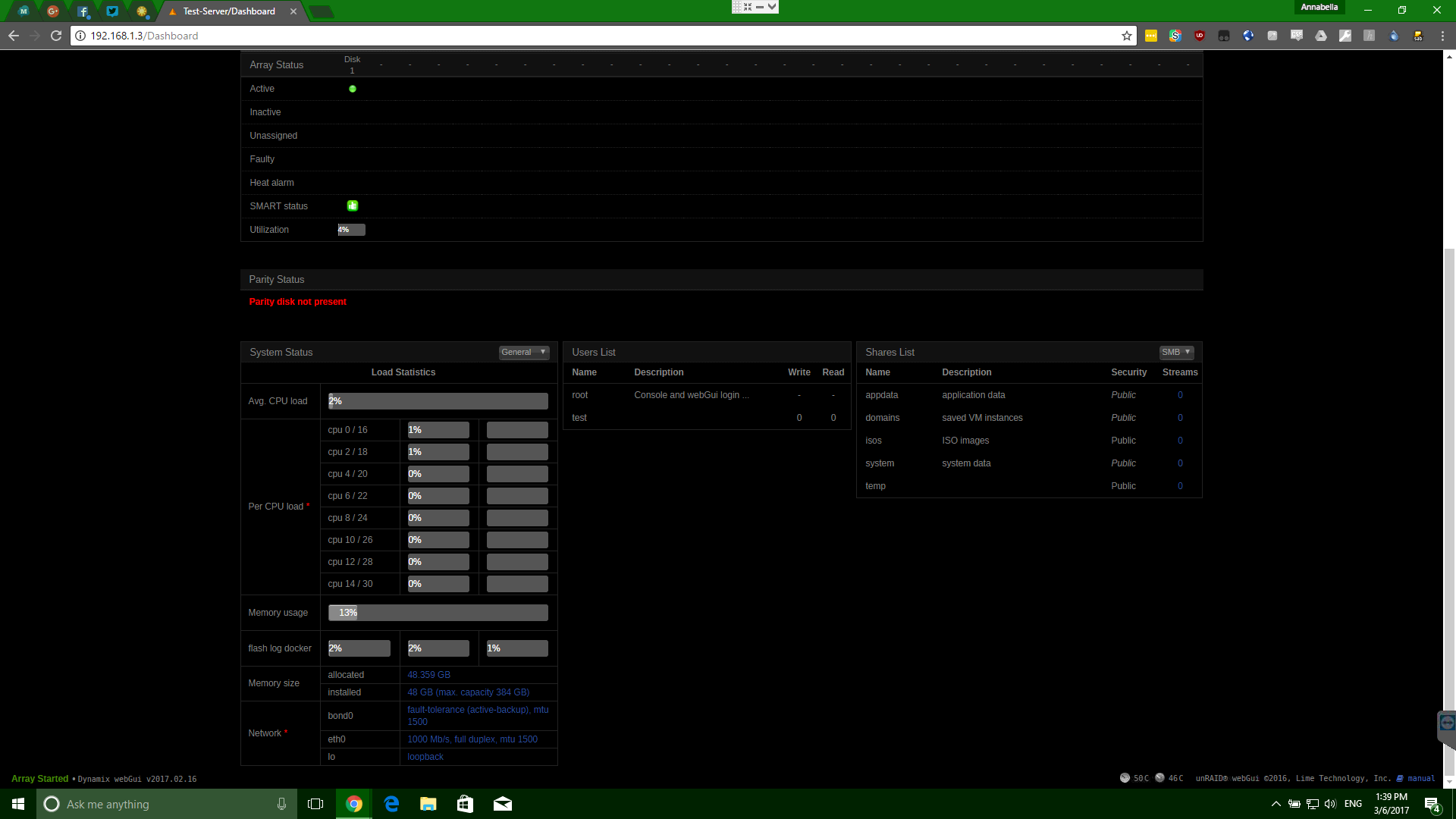

I'm having a similar issue.
I'm on a HP ProLiant DL370 G6.
root@Test-Server:~# cat /sys/devices/system/cpu/*/topology/thread_siblings_list
0,16
10,26
12,28
14,30
0,16
2,18
2,18
4,20
6,22
8,24
10,26
12,28
14,30
4,20
6,22
8,24
I'm running on unRAID 6.3.2, sorry for poking the thread.
Edited by AnnabellaRenee87
Added version I am running and a screenshot.

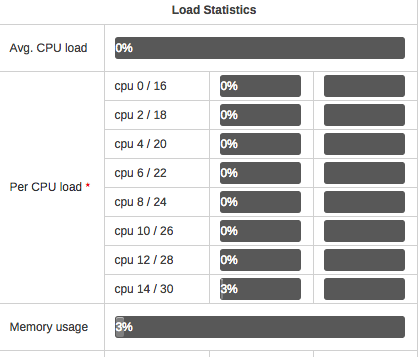

I upgraded one of my dl380 g6 server to 6.3.2 (rest are still on 6.2.4) and can confirm the same issue. But I come bearing gifts: diagnostics on 6.2.4 from just before updating, and diagnostic from after. Not sure if they will be that helpful, but they can't hurt.
modified vm xml to reflect new cpu layout and it booted fine but is only showing usage on 2 threads of the 4 assigned... interesting stuff....
-editing to update as I experiment-
If I assign 8,10,12,14,  the dashboard shows usage on 4,6 (not reflected in images uploaded.)
If I assign 24,26,28,30, the dashboard shows usage on 12, 14.
So, it is taking 2 assigned threads, halving the number, and slamming them on 1 host thread? The vm reports 4 cores and shows 4 cores of activity in both circumstances.

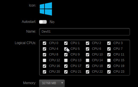

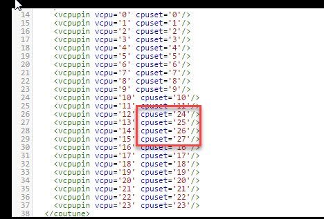

1 hour ago, Tharosh said:
Is there any way to work around it? Or must i install a previous Version to the Stick?

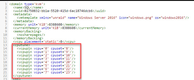

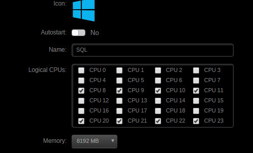

I found a work around is to to the main dashboard and look at what cpu numbers are listed under system status and only use those numbers.
If you want to use a cpu number that is listed under system status but not in the gui for the VM then you need to edit the XML to do so.
only use CPUs listed here
If you want to use one that isn't listed here
you can choose to edit xml instead of edit and change the vcpupin vcpu=... lines to what you want and it works.
Edited by Liemander
screenshots
Thanks for the advise and example. I will go with that! At least i can use 4 Cores that's way for hopefully a short period of time.
You should be able to use all cores thru this method. A better example would of been a VM I have set up to use all my available cores.
In my case my CPU list skips cpu cores 12-15 but adds additional cores 24-27. in reality I should only have cores up to 23.
In the GUI I can't use cores 12-15 because they don't exist according to unRaid.
What I did was assign all the cores anyway and then edited the XML after the fact.
I changed the broken cores 12-15 into cores 24-27.
What I found would occur for my dl380 servers is that in 6.3.x unRaid would put group 2 cores from a vm together on to one thread of a lower numbered core. Weird stuff. And I had no way of accessing the higher core number since they were always being combined. Workaround don't work for mine. Had to roll back to 6.2.4 to regain full usability of all cores.

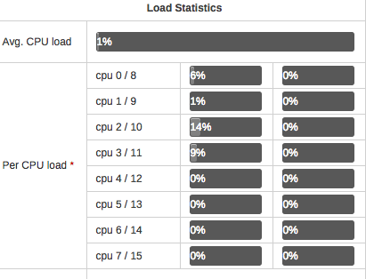

I'd like to report some positive news on the horizon:
I had a spare usb and booted the 6.4rc on a dl380 G6 running dual E5520 processors and the numbering was correct. I did not attempt it on one of my x5670 processor servers as they can't be taken off-line at the moment. Looking forward to skipping past 6.3 when 6.4 is ready to go!
cpu 0 <===> cpu 8
cpu 1 <===> cpu 9
cpu 2 <===> cpu 10
cpu 3 <===> cpu 11
cpu 4 <===> cpu 12
cpu 5 <===> cpu 13
cpu 6 <===> cpu 14
cpu 7 <===> cpu 15
cpu 0 <===> cpu 8
cpu 1 <===> cpu 9
cpu 2 <===> cpu 10
cpu 3 <===> cpu 11
cpu 4 <===> cpu 12
cpu 5 <===> cpu 13
cpu 6 <===> cpu 14
cpu 7 <===> cpu 15
Same here.  Upgraded to the RC and my core numbers are back to normal.
Ditto, fixed here too.
