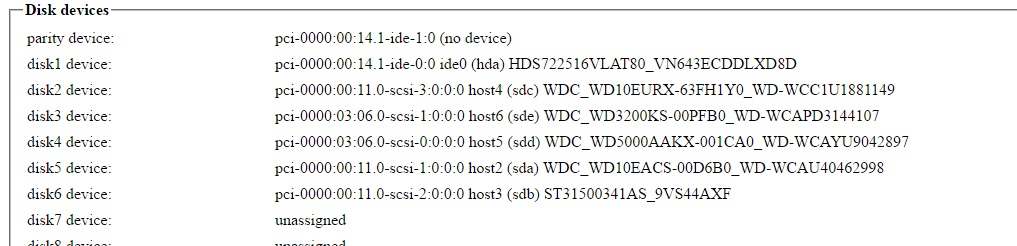

1) I realized that our server wasn't performing up to par - we've had various power issues, with storms etc. - and the battery backup that services the disk array was in alarm.
2) I pulled up the server and saw that the PARITY disk was offline, but everything else seemed to be working.  I needed to copy some files from the server and it did so without complaint.
3) I have a jpeg showing the configuration that appears when i looked it up.
The PARITY, & ( DISK4, DISK5, DISK6 ) all live in a small rack outside of the actual server case and have their own powersupply.  ( the one in alarm )
I shut down the array and went down to check power and data connections.  The external nature of this arrangement has meant that i have done this a couple times over the last few years.
NOW HERE IS THE PINCH - PARITY and DISK6 share a power circuit from the powersupply, and earlier when using the array i never touched anything on DISK6.  In fact theres a good chance that DISK6 hasn't been used specifically for anything in a long time.
- next - made my heart sink.  I replugged the power and data cables and turned the stack on.  the powersupply started, went into alarm, and smoke came from the back of DISK6.....
I unplugged DISK6 and started the server.
Everything comes up - but the array says that the PARITY is a new disk......  and of course with DISK6 out, this thing is not going to start freely for me.
Look, I don;t care about whats on DISK6.  I do care about the rest of the array.
HELP?
Attaching a pic of the setup and the syslog
syslog.txt
Edited by 1humshark

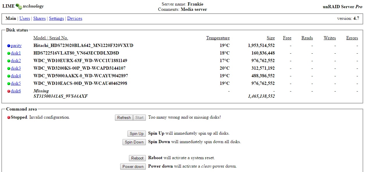

OK -
just to be clear.  I'm attaching a pic of the array currently.
To successfully start the array without disk six.
Should I un-assign the device for disk 6 before performing the initconfig ?
Sorry - when the data is at stake - I get all nervous nilly  =)
Anyway  - quick question.  is there a way to bring this up on the parity drive like it had never been disconnected?  Is this unwise?
That way the whole array could come up and function until I replaced disk6 tomorrow.  Just a thought.
OR is this past that point, and the only thing to do is init config and go......
Since the disk is already missing you can't (and there's no need) to unassign it.
AFAIK not with v4.7, there's a way to trust parity but a parity check would start immediately after array start, you'd need to use a new disk in place of the missing disk so parity would be corrupted.
